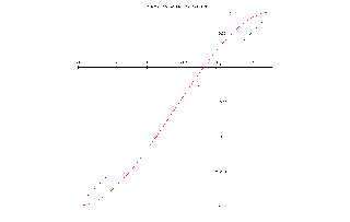

I was playing around with the examples on Mike William's Isosurface Tutorial
page (excellent site, I bookmarked it and refer to it constantly).  The one
I'm focused on is a parametric lathe that uses a spline to define different
profiles in two axes.  I'm wondering if there is a way to produce a similar
object without the point at the top.  I tried moving the endpoint of the
spline closer to the second point but the object distorts as if there is an
asymptote there.  What I'm looking for is an object bound by splines with
rounded ends.  Here is an example rendering and the code used to generate
it:
// Almost a lathe
#version 3.5;
camera { location  <3, 3, -5> look_at <0, 0, 0> angle 25}
sky_sphere { pigment {
    function{abs(y)}
    color_map { [0.0 color blue 0.6] [1.0 color rgb 1] }
light_source {<100,200,-500> colour rgb 1}
// The open 1D spline (lathe)
#declare S = function {
   spline {
    natural_spline
      -1, < 0.0, 0, 0.0>,
    -0.8, < 0.4, 0, 0.5>,
    -0.5, < 0.2, 0, 0.2>,
    -0.2, < 0.2, 0, 0.2>,
     0.3, < 0.8, 0, 0.4>,
       0.4, < 0.0, 0, 0.0>
#declare Fx = function(x,y) {(S(u).x * sin(v)/2)}
#declare Fy = function(x,y) {u}
#declare Fz = function(x,y) {(S(u).z * cos(v)/2)}
#declare Umin =  -1;
#declare Umax =  1;
#declare Vmin =  -pi;
#declare Vmax =  1.001*pi;
parametric {
  function {Fx(u,v)}
  function {Fy(u,v)}
  function {Fz(u,v)}
      <Umin,Vmin>,<Umax,Vmax>
  contained_by{box{-1,1}}
  precompute 18, x,y,z
  pigment {rgb 0.9}
  finish {phong 0.5 phong_size 10 ambient 0.2}
Download 'param.jpg' (7 KB)

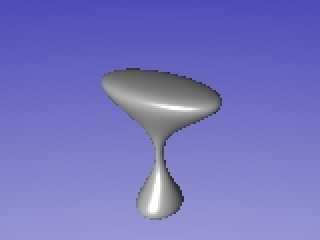

I fiddled a bit with the spline..
This looks reasonably well for me :
   spline {
    natural_spline
    -1.1, <-1.00, 0,-1.25>,
    -1.0, < 0.00, 0, 0.00>,
    -0.8, < 0.40, 0, 0.50>,
    -0.5, < 0.20, 0, 0.20>,
    -0.2, < 0.20, 0, 0.20>,
     0.3, < 0.80, 0, 0.40>,
     0.4, < 0.00, 0, 0.00>
     0.5, <-2.00, 0,-1.00>
Here you can see that extremer values distort the shape also :
   spline {
    natural_spline
    -1.1, <-2.00, 0,-2.50>,
     0.5, <-4.00, 0,-2.00>
To cut the shape at the apex you should also use
  #declare Umax =  0.4;
instead of
  #declare Umax =  1;
Hope this was helpful,
Thies

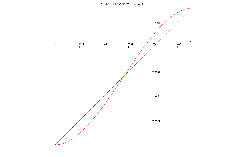

I just had another idea:
If you take a new function for your y-coordinate (which
varies linearly with u at the moment) you can have a smooth
tip. Imagine that you wander along your y-axis as u increases
from -1 to 0.4 eventually. If you start slowly, get more pace
in the middle and slow down near the end you get a smooth tip.
(I made a graph to show the y-function dependent on u).
The cubic u^2*(3-2*u) is ideal for this purpose because it
has zero-slope at u=0 and u=1. The only problem is that our
u varies from [-1, 0.4] instead of [0, 1], so we have to make
a small transformation to get our u in the range [0, 1]. We
just substitute u with (u+1)/1.4 and get the u-range right.
The last step is the scaling in y-direction, because
u^2*(3-2*u) returns values in the range [0, 1]. In summary:
   u^2*(3-2*u)                      // set (u+1)/1.4 for u
-> ((u+1)/1.4)^2*(3-(u+1)/1.4) // *1.4 // -1
-> 1.4*((u+1)/1.4)^2*(3-(u+1)/1.4)-1
The Source looks like this:
// Almost a lathe
#version 3.5;
    function{abs(y)}
   spline {
    natural_spline
    -1.0, < 0.0, 0, 0.0>,
     0.4, < 0.0, 0, 0.0>,
{1.4*(5/7*(u+1))*(5/7*(u+1))*(3-2*(5/7*(u+1)))-1}
#declare Umin =  -1;
parametric {
  function {Fx(u,v)}
  function {Fy(u,v)}
  function {Fz(u,v)}
  pigment {rgb 0.9}
Download 'u-coordinate.png' (8 KB) Download 'almost_lathe.JPG' (7 KB)
Preview of image 'u-coordinate.png'
Preview of image 'almost_lathe.JPG'

From: Skip Talbot
Subject: Re: Parametrics with pointy tips
Date: 17 Mar 2004 14:28:28
Message: <4058a6dc$1@news.povray.org>
Fantastic, thanks Thies!
