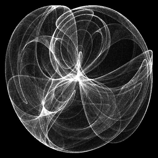

The code for this image is by Manuel Kasten, who posted it in
povray.general.
The strange attractor is iterated 2 million times.
This rendering was done entirely in POV using a machine with 384Mb of
memory.
There are 207620 spheres in the image.
Instead of adding a new sphere for each iteration of the strange attractor,
if there already was a sphere at a point I just changed its pigment to make
it brighter. Some spheres have had their pigment brightened 161 times which
gives them a pigment of about {rgb 5}. I had to make the brightening so
strong because the vast majority of spheres only get brigtened a few times
and when I tried creating output in teh range {rgb 0} to {rgb 1} most of
them were nearly black.
Download 'StrangeA2.jpg' (75 KB)
Preview of image 'StrangeA2.jpg'

You added a "measure."  Nice!
How did you decide whether there already was a sphere at a point?  I
mean, what did the POV code look like for that?  I've been trying to do
this, but my solutions are always very inefficient.  I'm guessing that
you store the locations in an array and compare (?)
Thanks
Dave Matthews

Yes. I accumulated the brightnesses in an array and then only created
spheres where the brightness was non-zero. It wasn't particularly
efficient. 2h 47m 59s on a 850MHz Celeron.

Thanks.  That's still a big improvement over my methods.  I was creating
the spheres, storing each location in an array, then running a new
comparison each time to see whether I already had a sphere. . . . I
still don't think enough like a programmer.
Well, now I can give it a go on a 3D IFS and see what comes out.
Thanks again!
