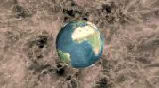

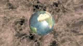

I have been rendering a set of frames for a simple animation, and out of the
360 frames I noticed that some didn't have any of the highlights or
reflections that they should.
I've attached anismall008b.jpg, and as you can see, there's no highlight
spot.  If I just render the same frame again, I get anismall008.jpg with the
highlight.
I was out to lunch, so I definitely didnt change the scene file mid-frame.
Any ideas?

No, it's a simple light_source{<3, 0,-5>*1000, color 3.0}, and the frames
were all rendered in one sequence for the whole lot.
Incidentally, the only bit of "animation" in the scene file is the spinning
of the globe:
union{
  object{Globe}
  rotate -360*y*clock
  rotate 23.5*z
Mark

There was/is going to be some more stuff there, like lat/long lines and
location markers
> I'd suspect the isosurface accuracy or max_gradient, or perhaps some
> CSG anamoly, if it weren't for the solitary frame rendering you tried and
> got highlights from that. So, that leaves scale of the things used in your
> scene I guess. Is the highlighting portion a separate surface very, very,
> close to the rest of the Earth surface?
The highlight is using a material map, so it's all on one object
    texture{
        material_map
             png "earthspec1k.png" map_type 1 once//0 is land, 1 is sea
            texture{pigment{PigEarth} normal{NorEarth} finish{FinLand}}
            texture{pigment{PigSea} normal{NorEarth} finish{FinSea}}
    rotate 270*y
> And how is it built together if it is a water, land parts... union,
> difference, intersection, merge?
One Isosurface{}
