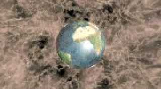

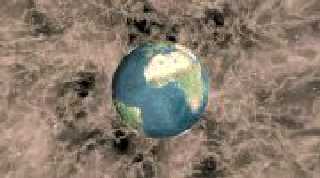

I have been rendering a set of frames for a simple animation, and out of the
360 frames I noticed that some didn't have any of the highlights or
reflections that they should.
I've attached anismall008b.jpg, and as you can see, there's no highlight
spot.  If I just render the same frame again, I get anismall008.jpg with the
highlight.
I was out to lunch, so I definitely didnt change the scene file mid-frame.
Any ideas?

From: Samuel Benge
Subject: Re: Strange lack of highlight when rendering an animation...
Date: 29 Oct 2003 10:55:43
Message: <3F9FE2F9.2030907@hotmail.com>
Does the animation use a shadowless light_source? That's the only reason
I can think of explaining why there is no highlight..... Shadowless
light_sources never produce them.

From: Mark Hanford
Date: 29 Oct 2003 11:01:18
Message: <3f9fe44e@news.povray.org>
"Samuel Benge" <sbe### [at] hotmailcom> wrote in message
news:3F9### [at] hotmailcom...
No, it's a simple light_source{<3, 0,-5>*1000, color 3.0}, and the frames
were all rendered in one sequence for the whole lot.
Incidentally, the only bit of "animation" in the scene file is the spinning
of the globe:
union{
  object{Globe}
  rotate -360*y*clock
  rotate 23.5*z
Mark

From: Hughes, B
Date: 29 Oct 2003 18:49:29
Message: <3fa05209@news.povray.org>
"Mark Hanford" <pov### [at] hanfordonlinecouk> wrote in message
news:3f9fe44e@news.povray.org...
> union{
>   object{Globe}
>   rotate -360*y*clock
>   rotate 23.5*z
Not sure why you unioned a single object. Although I don't think that would
cause a problem, except for a error message. I'd suspect the isosurface
accuracy or max_gradient, or perhaps some CSG anamoly, if it weren't for the
solitary frame rendering you tried and got highlights from that. So, that
leaves scale of the things used in your scene I guess. Is the highlighting
portion a separate surface very, very, close to the rest of the Earth
surface? And how is it built together if it is a water, land parts... union,
difference, intersection, merge?
Bob H.
From: Mark Hanford
Date: 30 Oct 2003 08:38:44
Message: <3fa11464$1@news.povray.org>
"Hughes, B." <omn### [at] charternet> wrote in message
news:3fa05209@news.povray.org...
> > union{
> >   object{Globe}
> >   rotate -360*y*clock
> >   rotate 23.5*z
would
There was/is going to be some more stuff there, like lat/long lines and
location markers
> I'd suspect the isosurface accuracy or max_gradient, or perhaps some
> CSG anamoly, if it weren't for the solitary frame rendering you tried and
> got highlights from that. So, that leaves scale of the things used in your
> scene I guess. Is the highlighting portion a separate surface very, very,
> close to the rest of the Earth surface?
The highlight is using a material map, so it's all on one object
    texture{
        material_map
             png "earthspec1k.png" map_type 1 once//0 is land, 1 is sea
            texture{pigment{PigEarth} normal{NorEarth} finish{FinLand}}
            texture{pigment{PigSea} normal{NorEarth} finish{FinSea}}
    rotate 270*y
One Isosurface{}
