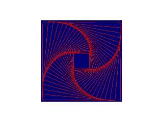

I would like any help someone can give regarding a math problem in Povray.
I have included an image of what I'm trying to accomplish, however it's
never quite perfect.  I'm trying to start with a small square in the center
(1x1 size) and increase its size to 5x5 and rotate the square as I go.  I
want the squares to match up so each square corner perfectly matches up with
a line on the next larger square.  Basically end up with a curving line made
of many squares. I'm doing it all by trail and error and never getting it
clean enough.  The square image here is small and doesn't show the
discrepancies as much, but once it is increased in size it never lines up
cleanly. Is there a math formulae to create this?  Is there a name for this
type of thing?
Thanks for any help!
Patrick Dugan

Well I used the orthographic view and it really makes the discrepancies
stand out.  While it helps in seeing the drawing "head on"
it still doesn't help in the math of things.  I rather not keep using trial
and error math if a formulae is around that would
make it cleanly.

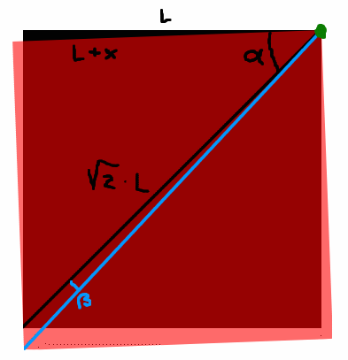

If I have understood it correctly, this is what you want (see picture
attached).
The green corner (top-right) is the center of the squares, so that what you
see are just the lower-left quadrants. The black square is the "old" (and
smaller) one, with side L, the red square is a larger one (side L+x) laid
over the black one and rotated.
As it is drawn, the cosine of the angle alpha is (L+x)/(sqrt(2)*L), but
you're interested in angle beta, which is:
beta = 45 - degrees(acos( (L+x)/(sqrt(2)*L) ))
beta = 45 - degrees(acos( (1+x/L)/sqrt(2) ))
If, as it seems, you want to make the squares smaller and smaller, just
substitute L+x -> L and L -> L-x:
beta = 45 - degrees(acos( L/(sqrt(2)*(L-x)) ))
... unless I've made a mistake...

Message: <Xns940EAF638C27CNone@204.213.191.226>
"Patrick Dugan" <pat### [at] netinsnet> wrote in news:3f847253$1
@news.povray.org:
> Thanks!    Replacing that line in the code seems to have worked well.
Great, I'm glad I could help.
