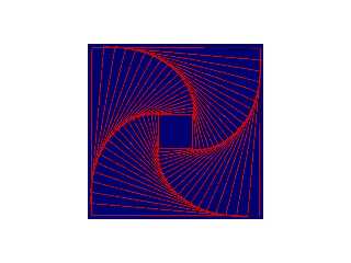

I would like any help someone can give regarding a math problem in Povray.
I have included an image of what I'm trying to accomplish, however it's
never quite perfect.  I'm trying to start with a small square in the center
(1x1 size) and increase its size to 5x5 and rotate the square as I go.  I
want the squares to match up so each square corner perfectly matches up with
a line on the next larger square.  Basically end up with a curving line made
of many squares. I'm doing it all by trail and error and never getting it
clean enough.  The square image here is small and doesn't show the
discrepancies as much, but once it is increased in size it never lines up
cleanly. Is there a math formulae to create this?  Is there a name for this
type of thing?
Thanks for any help!
Patrick Dugan
Here is the code I created for what it is worth:

From: Samuel Benge
Subject: Re: Rotating Squares problem
Date: 8 Oct 2003 13:34:36
Message: <3F844AA8.4020107@hotmail.com>
One major problem I see here is that your camera is using the standard
settings. Point of view, along with perspective's distortive effects
might be hindering you from achieving your desired effect. Try making
the camera orthographic and go from there.

From: Patrick Dugan
Date: 8 Oct 2003 13:45:41
Message: <3f844d45$1@news.povray.org>
Well I used the orthographic view and it really makes the discrepancies
stand out.  While it helps in seeing the drawing "head on"
it still doesn't help in the math of things.  I rather not keep using trial
and error math if a formulae is around that would
make it cleanly.

From: Samuel Benge
Date: 8 Oct 2003 14:33:55
Message: <3F84588F.3030304@hotmail.com>
My initial attempts to solve the problem have failed. I'm getting the
same corner-clipping artifacts you are. Maybe the folks over at
povray.avanced-users could help.

From: Mike Williams
Date: 8 Oct 2003 15:32:36
Message: <qgiG2GAyXGh$EwK3@econym.demon.co.uk>
>type of thing?
I can work out the math for calculating what the correct amount of
rotation (Z) should be, given the values for your "Reduction" variable,
like this (using the unincremented value of X):
// Length of new hypotenuse
   #declare H = X + Reduce;
// solve simultaneous equations A+B=H, A^2 + B^2 = X^2
// (By substituting "H-A" for "B", moving everything
// over the left hand side and using the standard
// quadratic equation solver for A.
   #declare A = (2*H + sqrt(4*H*H  - 8*(H*H - X*X)))/4;
// use trig to find the angle
   #declare Z = Z + degrees(acos(A/X));
// then increment X
   #declare X = X + Reduce;
The problem then is that when you create the fan, the 5x5 square is
significantly past vertical.
I did some experiments with different initial values of "Reduction" and
its increment, (changing the while clause to "#while (Z <= 90)" helps)
but it seems that the squares want to become vertical again at a size
between 3.9 and 4.4 rather than 5. To get the size close to 5x5 I had to
use very low values for "Reduction" and its increment, which causes
hundreds of squares to be generated.
Mike Williams
Date: 8 Oct 2003 16:10:36
Message: <Xns940EA48DB33F6None@204.213.191.226>
"Patrick Dugan" <pat### [at] netinsnet> wrote in
news:3f844537@news.povray.org:
> Povray.
Sounds like a trig. problem...
I think Reduce should simply be set to something like:
#declare Reduce = X * tan(radians(4.725));
From: Jellby

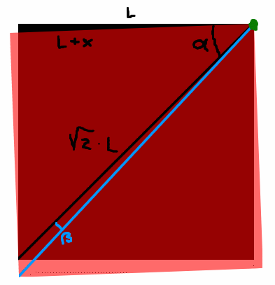

> center
> with
> made of many squares. I'm doing it all by trail and error and never
> getting it
> this type of thing?
If I have understood it correctly, this is what you want (see picture
attached).
The green corner (top-right) is the center of the squares, so that what you
see are just the lower-left quadrants. The black square is the "old" (and
smaller) one, with side L, the red square is a larger one (side L+x) laid
over the black one and rotated.
As it is drawn, the cosine of the angle alpha is (L+x)/(sqrt(2)*L), but
you're interested in angle beta, which is:
beta = 45 - degrees(acos( (L+x)/(sqrt(2)*L) ))
beta = 45 - degrees(acos( (1+x/L)/sqrt(2) ))
If, as it seems, you want to make the squares smaller and smaller, just
substitute L+x -> L and L -> L-x:
beta = 45 - degrees(acos( L/(sqrt(2)*(L-x)) ))
... unless I've made a mistake...

From: Patrick Dugan
Date: 8 Oct 2003 16:23:47
Message: <3f847253$1@news.povray.org>
Thanks!    Replacing that line in the code seems to have worked well.
