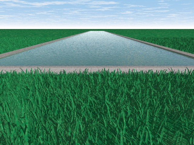

Ehehe, I'm new ;) (read: Inexperienced). Need to finish Grass, add
trees, other stuff. Feedback appreciated :)
Will post scene file in p.t.s-f so you can see how horrible it is :)

Good start, don't forget to put some reflective sphere as it is due for
a first post.  :-)
Some remarks:
- You put a green ground under the grass, at the first plane it really
gives an impression of syntethic grass.
- the line at which you stop putting grass blades is very visible, you
can improve it by putting grass that gradually becomes more scarce, that
should soften the limit.
JC

Yea, it's just temporary, It was better then the rgb<0,1,0> I was using :)
Yea, I got bored of typing in object{MyGrass a whole lot so I just
rendered it from where I was at :)

// > Yea, I got bored of typing in object{MyGrass a whole lot so I just
// > rendered it from where I was at :)
// You should learn how to do loops using the #while directive:
// (I'm assuming your ground is the xz-plane)
//   Sputnik
#local MyGrass =
  cone { -0.1*y, 0.1, y, 0
    scale <1, 1, 0.2>
    rotate 20*z
    pigment { color rgb <.2, .6, .2> }
    finish { ambient .3 diffuse .7 }
#local XMin = -5;
#local XMax =  5;
#local XStep = 0.4;
#local ZMin = -5;
#local ZMax =  15;
#local ZStep = 0.4;
#local Rand = seed(12345);
#local XCoord = XMin;
#while (XCoord<=XMax)
  #local ZCoord = ZMin;
  #while (ZCoord<=ZMax)
    object { MyGrass
      rotate <20+rand(Rand)*10, rand(Rand)*30, 0> // some random rotation
      translate <XCoord, 0, ZCoord> // transfer to destination
    #local ZCoord = ZCoord+ZStep;
    #end//while ZCoord
  #local XCoord = XCoord+XStep;
  #end//while XCoord
light_source { <-2, 1, -1>*100, color rgb 1 }
camera { location -25*z look_at 0 angle 25 rotate <20, -15, 0> }
