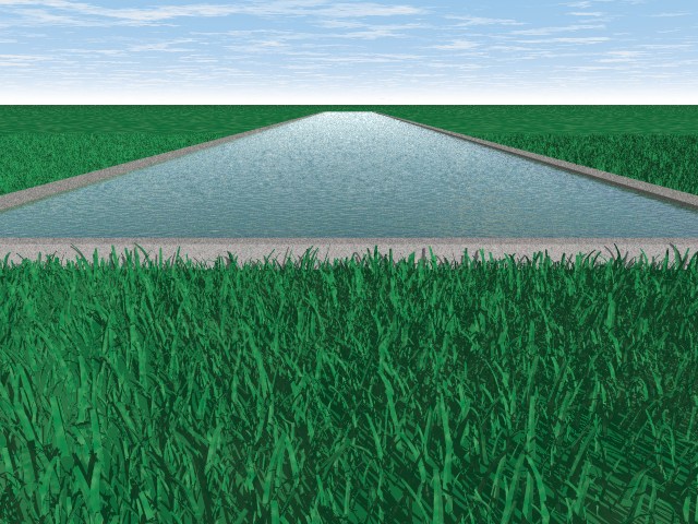

Ehehe, I'm new ;) (read: Inexperienced). Need to finish Grass, add
trees, other stuff. Feedback appreciated :)
Will post scene file in p.t.s-f so you can see how horrible it is :)
Download 'pool.jpg' (105 KB)
Preview of image 'pool.jpg'

Good start, don't forget to put some reflective sphere as it is due for
a first post.  :-)
Some remarks:
- You put a green ground under the grass, at the first plane it really
gives an impression of syntethic grass.
- the line at which you stop putting grass blades is very visible, you
can improve it by putting grass that gradually becomes more scarce, that
should soften the limit.
JC
> a first post.  :-)
> Some remarks:
Yea, it's just temporary, It was better then the rgb<0,1,0> I was using :)
Yea, I got bored of typing in object{MyGrass a whole lot so I just
rendered it from where I was at :)

// > Yea, I got bored of typing in object{MyGrass a whole lot so I just
// > rendered it from where I was at :)
// You should learn how to do loops using the #while directive:
// (I'm assuming your ground is the xz-plane)
//   Sputnik
#local MyGrass =
  cone { -0.1*y, 0.1, y, 0
    scale <1, 1, 0.2>
    rotate 20*z
    pigment { color rgb <.2, .6, .2> }
    finish { ambient .3 diffuse .7 }
#local XMin = -5;
#local XMax =  5;
#local XStep = 0.4;
#local ZMin = -5;
#local ZMax =  15;
#local ZStep = 0.4;
#local Rand = seed(12345);
#local XCoord = XMin;
#while (XCoord<=XMax)
  #local ZCoord = ZMin;
  #while (ZCoord<=ZMax)
    object { MyGrass
      rotate <20+rand(Rand)*10, rand(Rand)*30, 0> // some random rotation
      translate <XCoord, 0, ZCoord> // transfer to destination
    #local ZCoord = ZCoord+ZStep;
    #end//while ZCoord
  #local XCoord = XCoord+XStep;
  #end//while XCoord
light_source { <-2, 1, -1>*100, color rgb 1 }
camera { location -25*z look_at 0 angle 25 rotate <20, -15, 0> }
