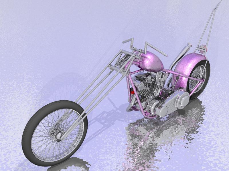

Hi guys, I'm trying to create a Metalflake finish in Pov-ray. Back in the
seventies it was a popular type of paint, using a very rough metallic flake
basecoat, under a smooth glossy transparant coloured paint. The texture I
used in this pic is:
texture { pigment { color red 0.200 green 0.000 blue 0.200 }finish{phong 2
roughness .05 specular 2 metallic .9 reflection .3} normal {bumps .3}}
it looks okay for the basecoat but needs a smooth glossy top layer.... Has
anyone got some tips or ideas how to improve this?
Mark van der Kwaak
www.dbbp.com

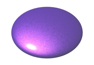

is putting a "real" outside coating around the metal parts out of the
question? i got this effect with this code, but it made the paint look more
blue. making a layered texture, i couldn't quite get it to look like this.
but i didn't spend much time.
#declare layered_paint_1 =
texture
        pigment
                rgb <0.200, 0.000, 0.200>
        finish{
               phong 2
               phong_size 10
               roughness .05
               specular 2
               metallic .9
               reflection .3
        normal {bumps .3}
sphere {
        <0, 5, 0>,5
        scale <1, .2, 1>
        texture {layered_paint_1 scale .01}
sphere {
        <0, 5.05, 0>, 5.05
        scale <1, .2, 1>
        texture {
        pigment {
                rgbt <.9, .9, 9, .95>
        finish {
                phong .75
                phong_size 130
                specular 1
                roughness .001
Download 'circle.jpg' (21 KB)
Preview of image 'circle.jpg'

Well, I thought of that but it would be a hell of a job....
there must be an easier way!
It's not a surprise that it's more blue when you do this. :o)
A layered texture is the answer.
Hugo

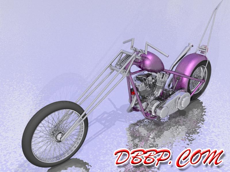

Thanks for all the input, this is what I came up with using the comments and
suggestions I received:
#declare metalflake3 =
texture { pigment {  rgb <.2, .0, .2> } finish { phong 2 phong_size 10
roughness .1 specular 2 metallic .9 reflection .3} normal {bumps .5} }
texture { pigment {  rgbt <.2, .0, .2, .95>     } finish { phong 1
phong_size 130 roughness .001 specular 1 reflection .2 }}
I started with almost clear top layers but the colour became too light,
after about 10 attempts this one was the best sofar......
What do you think?

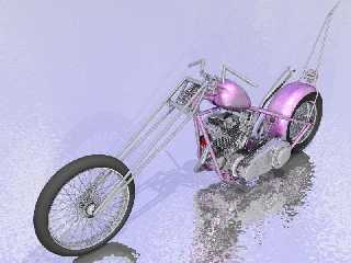

What do you think?
