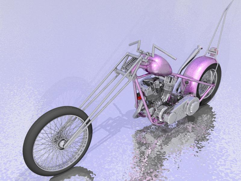

Hi guys, I'm trying to create a Metalflake finish in Pov-ray. Back in the
seventies it was a popular type of paint, using a very rough metallic flake
basecoat, under a smooth glossy transparant coloured paint. The texture I
used in this pic is:
texture { pigment { color red 0.200 green 0.000 blue 0.200 }finish{phong 2
roughness .05 specular 2 metallic .9 reflection .3} normal {bumps .3}}
it looks okay for the basecoat but needs a smooth glossy top layer.... Has
anyone got some tips or ideas how to improve this?
Mark van der Kwaak
www.dbbp.com

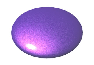

is putting a "real" outside coating around the metal parts out of the
question? i got this effect with this code, but it made the paint look more
blue. making a layered texture, i couldn't quite get it to look like this.
but i didn't spend much time.
#declare layered_paint_1 =
texture
        pigment
                rgb <0.200, 0.000, 0.200>
        finish{
               phong 2
               phong_size 10
               roughness .05
               specular 2
               metallic .9
               reflection .3
        normal {bumps .3}
sphere {
        <0, 5, 0>,5
        scale <1, .2, 1>
        texture {layered_paint_1 scale .01}
sphere {
        <0, 5.05, 0>, 5.05
        scale <1, .2, 1>
        texture {
        pigment {
                rgbt <.9, .9, 9, .95>
        finish {
                phong .75
                phong_size 130
                specular 1
                roughness .001
Download 'circle.jpg' (21 KB)
Preview of image 'circle.jpg'

Well, I thought of that but it would be a hell of a job....
there must be an easier way!
From: Hugo Asm
Subject: Re: Metalflake Motorcycle
Date: 6 Mar 2003 17:55:12
Message: <3e67d1d0$1@news.povray.org>
It's not a surprise that it's more blue when you do this. :o)
A layered texture is the answer.
Hugo

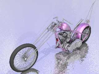

From: AArDvarK
Date: 7 Mar 2003 01:42:30
Message: <3e683f56$1@news.povray.org>
That is awesome! I think it is good that way
because of distance, great site you have,
and I sent you an E-mail called "Saw your
bikes".
Alex

From: Xplo Eristotle
Date: 7 Mar 2003 13:16:24
Message: <3e68e1f8@news.povray.org>
Glossy top layer = transparent pigment, no normal, tight specular
highlight, fresnel variable reflection. Remember to give the object an
interior {} with an ior for the fresnel reflection.
-Xplo

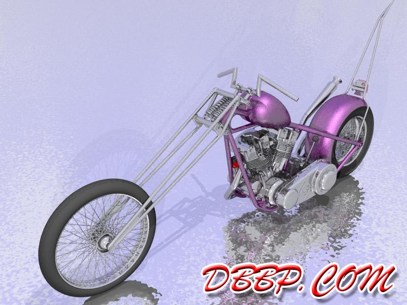

From: Duckman
Date: 7 Mar 2003 16:57:03
Message: <3e6915af@news.povray.org>
Thanks for all the input, this is what I came up with using the comments and
suggestions I received:
#declare metalflake3 =
texture { pigment {  rgb <.2, .0, .2> } finish { phong 2 phong_size 10
roughness .1 specular 2 metallic .9 reflection .3} normal {bumps .5} }
texture { pigment {  rgbt <.2, .0, .2, .95>     } finish { phong 1
phong_size 130 roughness .001 specular 1 reflection .2 }}
I started with almost clear top layers but the colour became too light,
after about 10 attempts this one was the best sofar......
What do you think?

From: Duckman
Date: 7 Mar 2003 16:57:12
Message: <3e6915b8@news.povray.org>
What do you think?

From: Martial
Date: 12 Mar 2003 15:33:20
Message: <3e6f9990@news.povray.org>
#include "colors.inc"
global_settings {assumed_gamma 1.8}
camera {location <0,10,-10>
right x*image_width/image_height look_at <0.0, 0.0,  0.0>}
light_source { z, rgb .5 translate -z*50 rotate x*70 rotate y*50}
background {White}
texture {
        pigment{rgb <0.200, 0.000, 0.200>}
        finish{
               phong 2
               phong_size 5
               roughness .05
               specular 2
               metallic .9
               reflection .3
        normal {bumps .3}
#declare layered_paint_2 =
texture {
        pigment {
                rgbt <.9, .9, 9, .80>
        finish {
                phong 2.9
                phong_size 200
                specular 2
                roughness .005
sphere {
        <0, 5.05, 0>, 5.05
        scale <1, .2, 1>
        texture {average
                texture_map {
               [.80 layered_paint_1]
               [.30 layered_paint_2]
        scale .001
Martial
