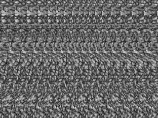

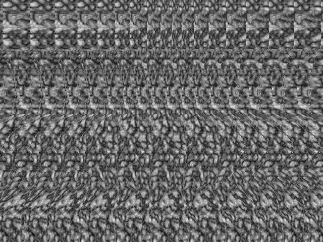

Thanks to Batronyx (Barrett) for his code to make
single image stereograms with POV.
Here is a single image stereogram of the classic POV-Ray
sample scene Skyvase.pov. This one is made for cross-eye
viewing.I've included the modified skyvase.pov scene for making
the depthmap.
Haroldd
-- skyvase depthmap ---
global_settings { assumed_gamma 2.2 max_trace_level 20 }
#include "shapes.inc"
#include "shapes2.inc"
#include "colors.inc"
#include "textures.inc"
#declare DMF_Hyperboloid = quadric {  /* Like Hyperboloid_Y, but more curvy
   <1.0, -1.0,  1.0>,
   <0.0,  0.0,  0.0>,
   <0.0,  0.0,  0.0>,
   -0.5
// camera repositioned to approximate a scene based on one unit depth
camera {
   location <0.0, -0.15, -1.0>
   look_at <0.0, -0.15, 0.0>
   angle 80
// No lights, only z gradient.
// Place entire original skyvase scene into a union
// remove original textures
union{
 union {
   union {
      intersection {
         plane { y, 0.7 }
         object { DMF_Hyperboloid scale <0.75, 1.25, 0.75> }
         object { DMF_Hyperboloid scale <0.70, 1.25, 0.70> inverse }
         plane { y, -1.0 inverse }
      sphere { <0, 0, 0>, 1 scale <1.6, 0.75, 1.6 > translate <0, -1.15,
0> }
      scale <20, 25, 20>
   sphere {  /* Gold ridge around sphere portion of vase*/
      <0, 0, 0>, 1
      scale <1.6, 0.75, 1.6>
      translate -7*y
      scale <20.5, 4.0, 20.5>
/* Stand for the vase */
 object { Hexagon
   rotate -90.0*z             /* Stand it on end (vertical)*/
   rotate -45*y               /* Turn it to a pleasing angle */
   scale <40, 25, 40>
   translate -70*y
 union {
   plane { z, 50  rotate -45*y }
   plane { z, 50  rotate +45*y }
   hollow on
// Scale the scene to be close to one unit depth, from closest object to
rear.
    scale 0.01
// ** Add texture gradient **
    texture {pigment {gradient z
// Remove next line to reverse depth map for cross-eye SIS
//     color_map{[0.0 White][1.0 Black]}
// adjust size and position of gradient textue to create optimal placement
// of light area (at the begining of the front object, the stand).
       finish {ambient 1 diffuse 0}
       scale 1.16 translate z*1.866}

From: Slime
Subject: Re: Skyvase SIS (cross-eye)
Date: 2 Feb 2003 16:20:04
Message: <3e3d8b84$2@news.povray.org>
The cross-eyed ones somehow don't seem to work as well.
Specifically, the edges of the top of the vase are hard to destinguish from
the walls behind it. The normal ones don't seem to have this problem so
much.
 - Slime
[ http://www.slimeland.com/ ]
From: Harold Baize
Date: 2 Feb 2003 17:47:14
Message: <3e3d9ff2@news.povray.org>
Yeah, I noticed that problem, but it seemed about the
same in cross or parallel, to me.
HB

That's cool! That's also something I haven't even thought of but makes perfect
sense now that you've done it; just reverse the gradient of the depthmap.
From: Harold
Date: 3 Feb 2003 13:25:40
Message: <3e3eb424$1@news.povray.org>
I should have read your page on creating depth maps more carefully.
You say not to use anti-aliasing because it can cause this problem.
I'll try it again without the AA and see how much it improves.
Harolddd
