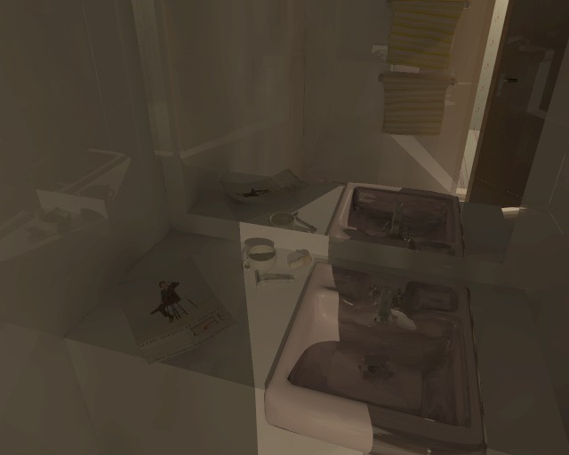

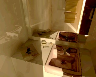

Hi all!
I'm having some problems with getting radiosity to look good in my current
IRTC project.
I've attatched three pictures
bathroom07_small_original.jpg is how it came out from POV-Ray
bahtroom07_gamma.jpg is gamma correceted to se the detais
bahtroom07_target.jpg is an gamma / brightness / contrast altered image, and
is somewhat what I aim for.
I tried using two lights, and it looked better, but you couldn't even spot
the light beam from the door, and that is an important part of the scene.
I'll model seperate tiles for the walls and sink, any tips for a good, clean
ceramic texture?
I use the following rad settings: (uses Jaimes save/load trick)
global_settings{
 assumed_gamma 1.0
 ambient_light 0.0
 #if (R)
iosity{
// indoor quick settings from rad_def.inc
    #if(R_Save)
          pretrace_start 0.08
          pretrace_end   0.01
          count 50+100
          nearest_count 5+15
          error_bound 0.5-0.25
          recursion_limit 2
          low_error_factor 0.8
          gray_threshold 0
          minimum_reuse 0.015
          brightness 1.0+1.5
          adc_bailout 0.01/2
          save_file "bathroom.main.radiosity"
    #else
        // load settings
        pretrace_start 1 pretrace_end 1
        load_file "bathroom.main.radiosity"
        error_bound 0.5    // it's important to specify the same value used to save
data
        recursion_limit 2  // also the same if specified
        always_sample off  // no more samples: specially useful with focal blur
    #end
 #end
The rad is collected in 320x240 res with dummy objects and no finishes (~45min). And
then rendered in 1280x1024 (~1hour)
Any help appreciated!
Kind regards
Peter
Download 'bathroom07_small_original.jpg' (7 KB) Download 'bathroom07_gamma.jpg' (27 KB) Download 'bathroom07_target.jpg' (18 KB)
Preview of image 'bathroom07_small_original.jpg'
Preview of image 'bathroom07_gamma.jpg'
Preview of image 'bathroom07_target.jpg'
Subject: Re: Some radiosity issues
Date: 31 Jan 2003 16:07:26
Message: <3E3AE58C.C6C9054@gmx.de>
Peter Hertel wrote:
> Hi all!
> IRTC project.
Your image is simply way too dark.  Making the light source much brighter
will certainly improve it (alternatively you can also try the film
exposure function in megapov).
Also note that modifying contrast/brightness/gamma in the (8 bit) image
afterwards will strongly reduce the quality - most artefacts in your third
image do not seem to be caused by radiosity but by the limited color
resolution.

From: Peter Hertel
Date: 3 Feb 2003 14:16:13
Message: <3e3ebffd@news.povray.org>
Doh.. something didn't connect properly in my brain..
I added a 150 light multiplyer to the light, and it worked great. I lost
most of the warm colors in the light though.. I'll have to play around some
more.
