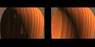

howdy all,
I made a rotational sweep in Moray, and the wood grain seems to follow the
normals just fine, but the light doesn't, is there something I'm not doing?
thanx,
DC

DC wrote:
> howdy all,
That does not seem to be a lathe object but a mesh, maybe check the POV
code.
It's a perfectly normal appearance for meshes, see:
http://www.students.tut.fi/~warp/povVFAQ/TheShadowLineArtifact/

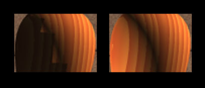

I just tested the idea and oops, It doesn't look like it will work anyway.
either way, some parts that should be shadowed aren't. it looks like I'll
just have to keep this in mind when I position certain things. I've noticed
too that the shadow's edge has less light then the ambience of the material.
is there a setting for this?
thanx again,
DC

Subject: Re: normal problem
Date: 20 Nov 2001 13:42:23
Message: <3BFAA40E.1544C7FD@gmx.de>
DC wrote:
> I can do the no shadow thing, but can't find where to do the no image.
> thanx again,
> DC
no_image is only available in megapov/Povray 3.5

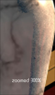

I've figured out an acceptable solution:
crank up the wireframe resolution on the parts that need it and presto!

oops, that's a reflection on the white thing,
DC
