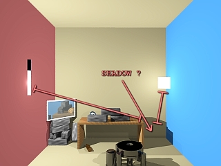

hello!
there are two lights in the scene. but there is one light that throws a
shadow where the other light would eat it with its luminiscence.
the left light i made with "looks_like" the other one with an
area_light. is there a difference? or what is the problem?
thanks
Download 'shadprob.jpg' (38 KB)
Preview of image 'shadprob.jpg'

Are you absolutely certain that there are only two lights? Some objects
can be clearly seen to be casting three shadows (e.g. the left leg of
the desk).
It's hard to tell, but it looks like the third light source is
positioned beyond the back wall, which would mean that the wall have
no_shadow.
Mike Williams
Gentleman of Leisure

Is that a mirror in the left corner? If so, the mirror is reflecting the light
effectively acting as a light source.
- Nekar
No!
Unless you are using photons of course.
To me there seems nothing wrong in the scene, but when seeing source we
could say more.
> the desk).
The appearance that there is another light casting shadows could be a result
of the area light.  It probably has a low number of samples creating
less-than-soft shadows.  Adding jitter could demonstrate if this is the
case.

there is no third light_source an the shadow comes definately from the lamp
left (or do i need glasses?).
here is the code:
Seems to render as expected.  It's probably the area light that causes the
confusion.  It is very large, and not very high quality.  Try commenting
it out or  use something like:
    area_light <0.3,0,0>,<0,0,0.3>,5,5
    jitter
and things will be much clearer.

christoph knew it:
i feel embarrassed... :)

 Yes, just have seen it. Also that the area would be more logical in a
plane parallel to the box major facet (x/y instead x/z):
     area_light <0.3,0,0>,<0,.3,0>,5,5
 isn't?
Jaime Vives Piqueres
>  isn't?
right
