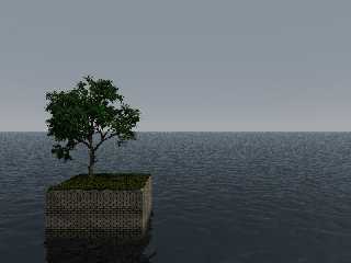

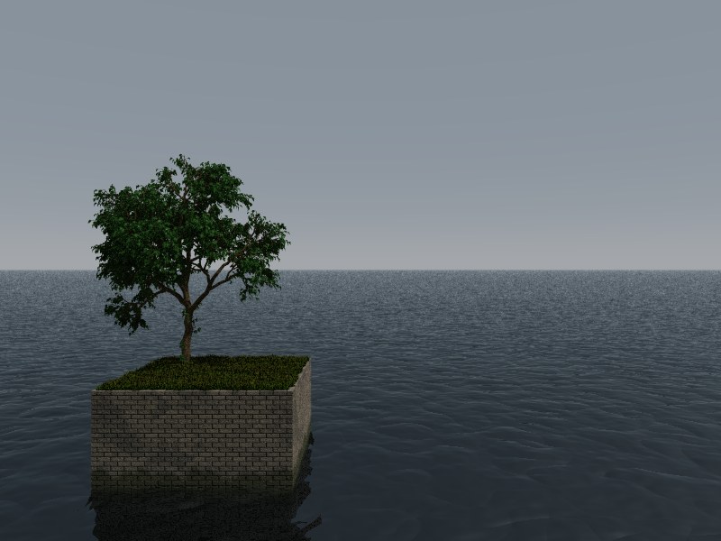

Well here is an updtaed version of the image I posted on 12/08/01. I have
played with the water a bit - still not overly happy. And the tree and grass
are supplied by Gilles Trans Macros.
I have ommitted the clouds as something strange happens when the tree is in
the scene and I wondered if anyone could answer why?
1. When I have the clouds and no tree in the scene it renders as normal.
2. If I have the tree and no clouds it renders as it should, flying through
until it hits the tree, but then still making a good pace.
3. If I have both then the render goes at 0pps from the start - it is this
that gives me the problems and I can't understand why.
I tried manual bounding and that then helped the scene render quickly until
it got to the tree bounding box and then it went very slow as the tree
doesn't like being bounded as a whole.
I was just wondering why 3. happens as it is bugging me. BTW the clouds are
a difference of two spheres to make a shell. Dunno if that helps?
Kev

Why a CSG difference for the clouds instead of one sphere?  Is the cloud
object extremely large?
I couldn't say what might be a solution besides.
Bob H.

Could you possibly have just filled the physical memory of your machine?
Things suddenly go a lot slower when it starts shuffling chunks of
scenery in and out of virtual memory. Try watching the drive light on
your hard disc, or try rendering a really tiny image of your scene and
look at the peak memory usage statistic that gets reported.

The clouds are made from media, hence the shell.
Kev

I've still got loads of Ram left so it's not that, I'm sure it must have
something to do with bounding.
