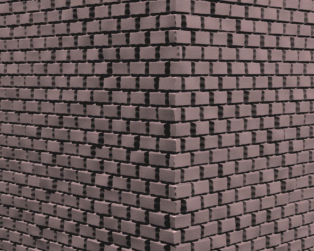

Hi, I've almost finished my brick wall prototype...
I think I just need to add texturing to the bricks so that the filling
between the bricks is of different color...
Also, there is a slight bug at the corner, but I think I'll leave it
that way for a moment...
What do you think?
I just found a way to fix the problem; though I don't think it's a
specially good way, it's just perfect for this kind of brick, it might
not work properly with other kinds of brick...

Xilo Musimene <xil### [at] hotpopcom> wrote in message
news:3EF### [at] hotpopcom...
You are using a heightfield?
Try a union with another heightfield for the mortar.  I just did that for my
wall heightfield macro and it looks great.
Not only can I have separate textures for bricks and mortar, but by changing
the relative size of the two heightfields the tiling is much less noticable.
RG

"Xilo Musimene" <xil### [at] hotpopcom> wrote in message
The edges look very wavy.
http://news.povray.org/povray.binaries.images/32032/?ttop=32188&toff=50

> You are using a heightfield?> Try a union with another heightfield for the mortar.
Yes, that seems easy enough!  I should have it done within a few days!
Thanks,
   Xilo
Do you mean the shape of the bricks?  Yea, the bricks are wavy, I can
make any kind of brick, but that's the one I rendered...  I'll try to
make a square type of brick with slightly round edges next time...
Xilo

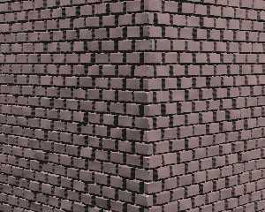

You can even do a single hf combining several ones with more complex
math functions (max and conditional functions) to generate height field
and according color map. I'm currently also trying to generate a sort of
finish map image.
I post an image of a wall I've made for my next IRTC, I'll post the code
at the same time as my image. You can see that I have more troubles than
you with the corner.  :-)
JC
> finish map image.
That's what I'll try to do...
Thanks,
   Xilo
