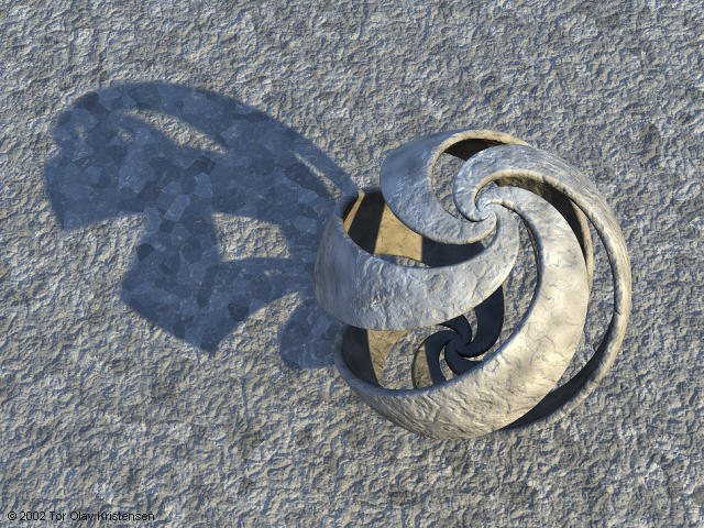

I'm not sure if this image is finished
or not now.
What do you think ?
Should I change something ?
I should probably mention that I had
to "hand correct" the finished image
somewhat at the sphere's "south pole".
(Because there seems to be some
calculations that are not calculated
correctly by POV-Ray. Increasing
max_gradient or accuracy did not help
at all.)
I have also used Micrografx Picture
Publisher to increase the contrast a
little.
Tor Olav
Download 'riemann16_.jpg' (109 KB)
Preview of image 'riemann16_.jpg'

All it needs is a guy looking up at it. Make him so small that he can be
mistaken for a spot, then you notice the shadow and the scale suddenly
shifts...

Fantastic, I like the image just as it is.
Congratulations,
Fernando.

If you defined the spiral correctly, that's because the spiral never ends,
the detail increases towards the poles infinitely. That is, if I understood
the description of the shape that I read a while ago correctly.

In an equiangular spiral (reverse Mercator projection of oblique
parallels), that would happen at both poles; TOK said only one.
What's the formula?

If that surface structure is a normal you could make it part of the
isosurface geometry.  Apart from that, do you have 'normal on' in

I think it's quite obvious that spiral structures lead to infinite
gradients which can't be rendered correctly under all circumstances.

Will it form a whole sphere when combined
with the y-rotated other textured one?

I tried to render your scene file posted in p.t.s-f
last month.  But I could not find any problem
on the image.  Did you use the same function?
