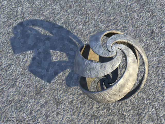

I'm not sure if this image is finished
or not now.
What do you think ?
Should I change something ?
I should probably mention that I had
to "hand correct" the finished image
somewhat at the sphere's "south pole".
(Because there seems to be some
calculations that are not calculated
correctly by POV-Ray. Increasing
max_gradient or accuracy did not help
at all.)
I have also used Micrografx Picture
Publisher to increase the contrast a
little.
Tor Olav
Download 'riemann16_.jpg' (109 KB)
Preview of image 'riemann16_.jpg'

All it needs is a guy looking up at it. Make him so small that he can be
mistaken for a spot, then you notice the shadow and the scale suddenly
shifts...

Fantastic, I like the image just as it is.
Congratulations,
Fernando.
> at all.)
If you defined the spiral correctly, that's because the spiral never ends,
the detail increases towards the poles infinitely. That is, if I understood
the description of the shape that I read a while ago correctly.
- Slime
[ http://www.slimeland.com/ ]

Tor Olav:
> > at all.)
Slime:
> never ends, the detail increases towards the poles infinitely.
> That is, if I understood the description of the shape that I
In an equiangular spiral (reverse Mercator projection of oblique
parallels), that would happen at both poles; TOK said only one.
What's the formula?
> or not now.
> What do you think ?
If that surface structure is a normal you could make it part of the
isosurface geometry.  Apart from that, do you have 'normal on' in
radiosity?
> at all.)
I think it's quite obvious that spiral structures lead to infinite
gradients which can't be rendered correctly under all circumstances.

Will it form a whole sphere when combined
with the y-rotated other textured one?
Gleb

"Tor Olav Kristensen" wrote in message
> or not now.
> What do you think ?
Nice image.
> at all.)
I tried to render your scene file posted in p.t.s-f
last month.  But I could not find any problem
on the image.  Did you use the same function?
R. Suzuki
