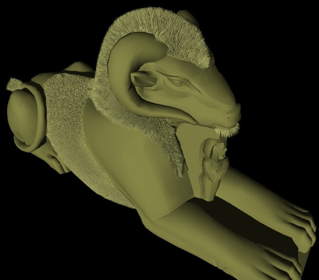

the plug-in is a max plug-in used only to get the geometric datas
(instead of writing a conversion tool, I used a small part of antoher
plug-in I did).
I'm using: vertices, normal, colors
all the computations are done in POV. I have a main macro that
interpolates those 3 values in an nearly homogeneous way on each
triangle (randomness is enabled or not by a boolean) then, for each
step, it calls a user defined macro with 3 parameters:
- position of the point
- normal vector
- color
in this render, I put cones at each step, I oriented them thanks to the
normal and I used the color to alter the length of the fur in a very
simple way.
I now have to create bounding slabs myself because when doing a render
with a large number of objects, it is the longest part of the parse process.
Does someone has advices for this objective ??
         Thanks.
                    David Gemelli
Download 'fur_punk_90k.jpg' (41 KB)
Preview of image 'fur_punk_90k.jpg'

Quite realistic in the way it looks light where something would normally
be dark and vice-versa.  Must eat memory though.

In fact, the "light artifact" is...not understood...there is only one
light source, a plain color (rgb <0.5, 0.5, 0.2>) and an ambient value
of 0.4...
And yes, it is eating a lot of memory (for the first statue, 256Mo of
ram and a swap file of 200Mo was not enough for the 460k cones!!)...I'll
do others additions to replace the cones by curves hairs and such things
to see what I can achieve...then, I'll do a "real" scene...

The usual solution to this sort of memory consumption is for someone to
suggest using a single mesh filament, referenced as often as required.
So I think I'll suggest it :)

Hmm. 'Punk'? It looks to me more like the kind of haircut people give to
poodles <g>.
Great fur tho.
