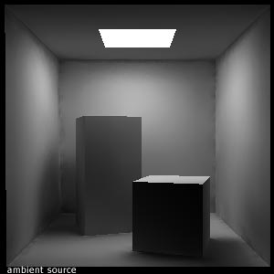

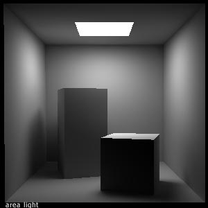

#version 3.5; // beta 6
To verify that my assumptions about povray light sources
are correct I tried to make ambient source with the same
lighting properties as a diffuse area light.
I think I got it but there is this mysterious constant 2*pi
which is required. I think the 2 comes from the fading equation
attenuation=2/( 1+(d/fade_distance)^fade_power ). The intensity
at the surface of the light is two times higher than at the fade
distance. But where does the pi come from? :)
http://www.pp.htv.fi/kkivisal/area.pov
_____________
Kari Kivisalo
Download 'ambient.jpg' (7 KB) Download 'area.jpg' (7 KB)
Preview of image 'ambient.jpg'
Preview of image 'area.jpg'
  Very interesting... but the area version looks better, soft and
without artifacts.
 Because light propagation is spherical? I've been reading a lot about
lighting lately, because I'm trying to relate common bulb properties to
pov light sources, and found many equations involving pi.
Jaime Vives Piqueres
http://www.ignorancia.org/
> without artifacts.
It's faster too. This was fundamental research to advance
povray science :)
