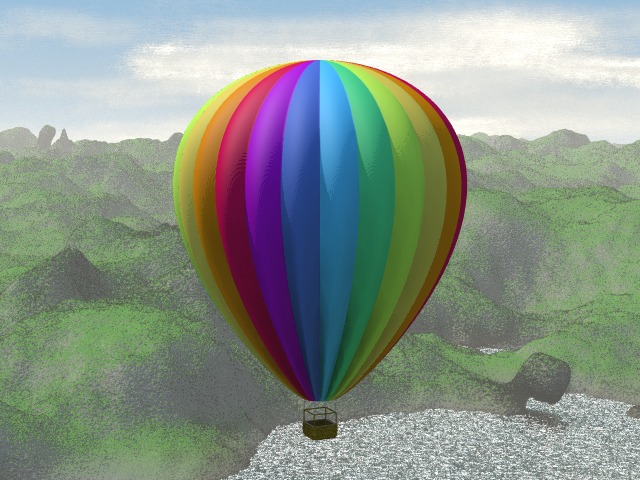

Some aspects are still lacking but this took a full week to render! The
water looks milky because of bad media settings but I don't think this will
interfere much in the rad load render. (dat's right, this WAS ONLY THE
SAVE!) I've really gotta cut back on these effects...
Download 'wip_balloon_trip_02.jpg' (118 KB)
Preview of image 'wip_balloon_trip_02.jpg'

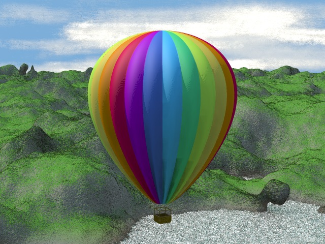

Full quality render of Balloon Trip is attached. It's still a WIP because I
still need to make the burner and possibly some other details and add a few
more balloons. Comments and suggestions welcome!
Download 'wip_balloon_trip_03.jpg' (104 KB)
Preview of image 'wip_balloon_trip_03.jpg'

Well the basics of it was to take a cylinder and add a sine wave about the
theta to it. All the troughs of the sine wave were inverted by taking the
absolute value (making 2 bumps per sine wave repeat). The rest was playing
with functions to get the width right and clipping with ordinary CSG.
Here's the function I used, and I might make the whole thing available if
people want it and I can manage to clean up the cancerously messy code
(1609 lines ATM).
#declare f_Balloon =
function
  x*x+y*y*y-y*y+z*z-abs(sin(atan2(x,z)*12))*-(pow(((y*2.1)-1.1), 2)-1)*0.02
Good luck! Just make sure to give me credit where you happen to use it, and
let me see your results! :-)

hello greg ...
played with it a bit today.
rather than clip using csg here's what i did:
with the threshold set at 0.003, i got a nice taper at the
bottom of the balloon instead of having it pinch off at zero.
the box containing it also serves to cut it off without having
to later do some difference function with it as an object to
lose the surface below zero Y. this uncomplicates things.
that also dropped the max_gradient from 6 or 7 to 1.4 or so
and that helped me speed up the render. ( however, looks like
that is dependant on the final location of the balloon in the
scene and not just the isosurface function.
just when i thought i had figured out how max_gradient worked. ;)
perhaps you will find some of this of use now or in the future.
(no way to post attachments from here right now.)
thanks again for getting me headed in the right direction.
isosurface {
  function {
  2)-1)*0.02}
     threshold 0.003
     max_gradient 1.5
     contained_by {box { <-0.45,-0.03,-0.45>,<0.45,1,0.45> }}
-ob-

I'm very impressed with "Balloon Trip".  I'm trying to create a beach ball
and have used your code to create the ball.  Just changed to 6 sections
(panels) instead of 12 and look down on the top of the balloon.  This works
fairly well but I have only been able to create a one color ball.  I am a
newbie to POV-Ray and have absolutely no idea how to give a different color
to each panel as your balloon has; not much of a beach ball with only one
color.  Could you please let me know how to apply multiple colors.
  Thanks
    Roy

Use a radial pattern type. It works a lot like the gradient pattern only
it's ...radial! Your code could be something like this:
pigment
  radial frequency 6
  colour_map
    [1/6 FirstColour]
    [2/6 FirstColour]
    [2/6 SecondColour]
    [3/6 SecondColour]
    // and so on...
Another hint is to only use the abs(sin(atan2(x,z)*12)) part of my code and
subtract it from a sphere (x*x+y*y+z*z-1) to make your ball round. :-)
I know, it took me a while to figure this out, too!
