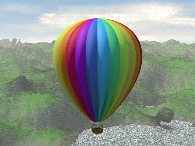

Some aspects are still lacking but this took a full week to render! The
water looks milky because of bad media settings but I don't think this will
interfere much in the rad load render. (dat's right, this WAS ONLY THE
SAVE!) I've really gotta cut back on these effects...
Download 'wip_balloon_trip_02.jpg' (118 KB)
Preview of image 'wip_balloon_trip_02.jpg'

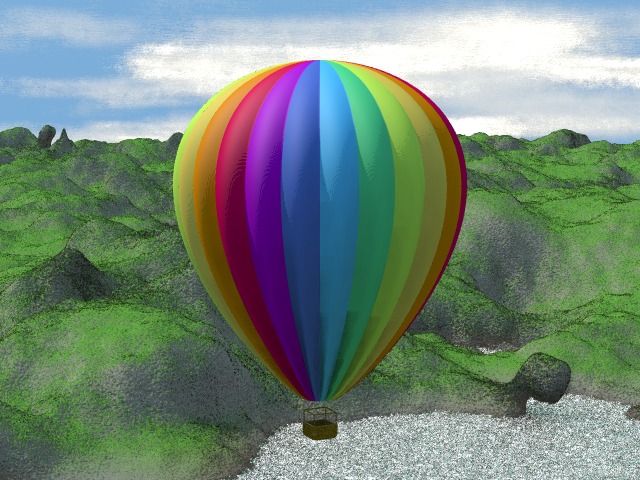

Full quality render of Balloon Trip is attached. It's still a WIP because I
still need to make the burner and possibly some other details and add a few
more balloons. Comments and suggestions welcome!
Download 'wip_balloon_trip_03.jpg' (104 KB)
Preview of image 'wip_balloon_trip_03.jpg'
From: Ryan Mooney
Subject: Re: WIP: Balloon Trip (higher quality)
Date: 3 Feb 2003 20:07:56
Message: <3E3F126F.3FC98329@earthlink.net>
CARTOONEY... =]
