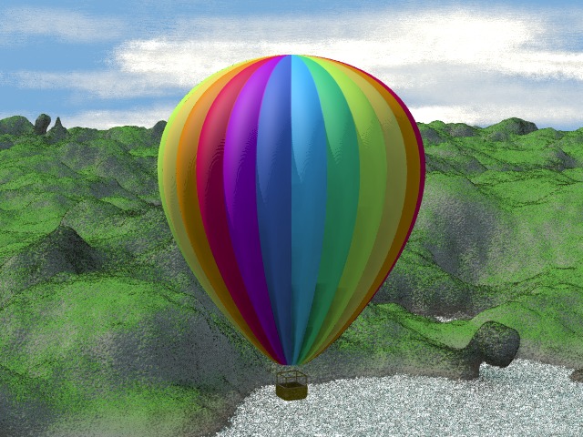

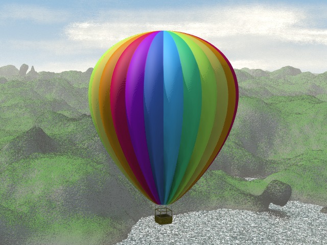

Some aspects are still lacking but this took a full week to render! The
water looks milky because of bad media settings but I don't think this will
interfere much in the rad load render. (dat's right, this WAS ONLY THE
SAVE!) I've really gotta cut back on these effects...
Download 'wip_balloon_trip_02.jpg' (118 KB)
Preview of image 'wip_balloon_trip_02.jpg'
From: Greg Edwards
Subject: Re: WIP: Balloon Trip (higher quality)
Date: 3 Feb 2003 16:29:57
Message: <xv2eemapfqfd.gmv1u29w90wu$.dlg@40tude.net>
Full quality render of Balloon Trip is attached. It's still a WIP because I
still need to make the burner and possibly some other details and add a few
more balloons. Comments and suggestions welcome!
Download 'wip_balloon_trip_03.jpg' (104 KB)
Preview of image 'wip_balloon_trip_03.jpg'

Well the basics of it was to take a cylinder and add a sine wave about the
theta to it. All the troughs of the sine wave were inverted by taking the
absolute value (making 2 bumps per sine wave repeat). The rest was playing
with functions to get the width right and clipping with ordinary CSG.
Here's the function I used, and I might make the whole thing available if
people want it and I can manage to clean up the cancerously messy code
(1609 lines ATM).
#declare f_Balloon =
function
  x*x+y*y*y-y*y+z*z-abs(sin(atan2(x,z)*12))*-(pow(((y*2.1)-1.1), 2)-1)*0.02
Good luck! Just make sure to give me credit where you happen to use it, and
let me see your results! :-)
