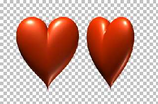

Once I needed a heart. It was something like a St.Valentine's day. I looked through
Internet, found some, bit didn't like any. So, now there is one more heart object in
Internet.
 The source of object is here.
//----------- Isosurface heart
#declare heart=
isosurface{
 function{
sqrt(pow(x*2.5,2)+z*z+pow(abs(y*1.1-0.8*sqrt(sqrt(z*z+pow(x/2,2)/(pow(abs(y+1.4),4)+0.001)))),2))-1
 accuracy 0.005
 max_gradient 5
 contained_by{box{-1.4,1.4}}
 texture{pigment{color red 1.4 green 0.3}finish{diffuse 1 specular 0.5 phong 1
phong_size 45}}
Sincerely Yours, Alex Kluchikov.
Download 'heart.jpg' (29 KB)
Preview of image 'heart.jpg'

From: SeeSchloss
Subject: Re: isosurface heart
Date: 23 Aug 2003 15:30:03
Message: <3f47c0bb$1@news.povray.org>
But... how can you find how to make such isosurfaces ??
From: Alex Kluchikov
Date: 24 Aug 2003 04:45:00
Message: <web.3f487aaa8f42f3213da88f510@news.povray.org>
 A lot of tries... A great number of faults...
 Actually, I always start modeling of isosurface objects from the sphere.
 x*x+y*y+z*z-1
 then deform it with some functions, for example, add
 1/(x*x+z*z+.1) to get funnel-shaped hole and so on.
 Try everything.
 The heart took 3 days to model...
 In next posts I'll put some more isosurface examples.
