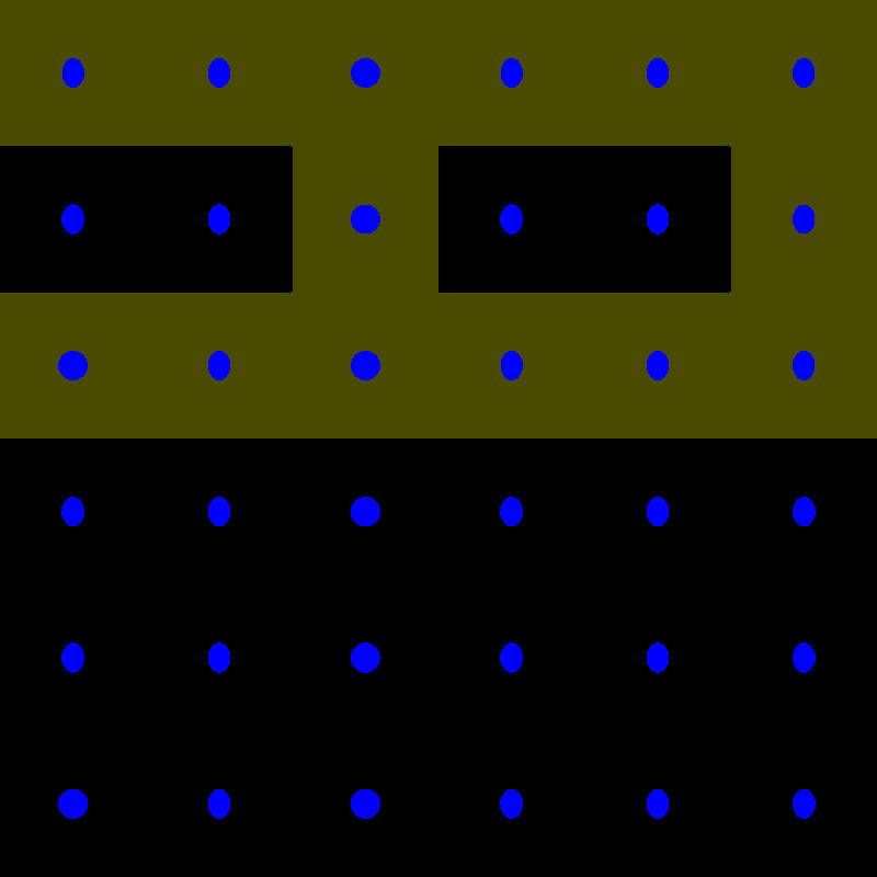

Another place the +mv sort of version spec is necessary is with the
unspecified default camera. Meaning with the following sort of set up:
#version 3.7;
global_settings { assumed_gamma 1.0 }
plane { -z, -1 pigment {rgb <1,1,0>} }
#version 3.5;
sphere { <0,0,1.0> , 0.1
     pigment { rgb <0,0,1> }
     finish { emission 1 } // Yes, this generates a warning.
// camera {} // Specified default camera grabs current version defaults
//---        // and its use is what is seen in the right three columns
Without writing a small chapter, the second and third columns of the
attached test image show that the ini / flag version setting is used
when there is a leading #version statement in the scene code - over the
version specified in that #version statement (or defaulted version).
