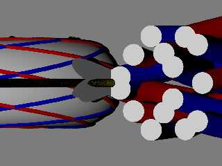

I am working on a scene to establish geometry for conversion to OpenSCAD.
I'm super close, but when I zoomed in to closely inspect how things were
positioned, I noticed that some objects simply weren't being properly lit.
Adding emission only partially remedied the situation.
The objects are all just a simple torus {} with plain rgb pigments.
But for some reason the yellow torus is the only one really affected.
Lights are just point lights.
Lit from the front with no obvious occlusion.
Adding a top light doesn't help.
The shadows are really weird too.
3.8 beta 2
Any ideas?
- BE
Download 'dupincyclide_3dprint.png' (118 KB)
Preview of image 'dupincyclide_3dprint.png'

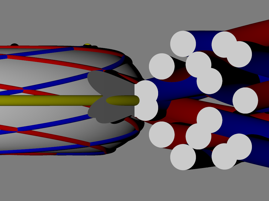

Bill W, This morning I got around to running the scene you sent to me -
thanks.
I can reproduce your image with my v3.8 beta 2 - except I don't get some
noise in the shadows near the top on the left. This difference a
surprise and I'm unsure what might be the cause. Differences in compiler
settings? Differences windows to linux? Some difference in ini / command
lines settings? I don't know. I took a few shots in the dark trying to
reproduce the shadow noise without success.
When your scene is run with my current development yuqk fork, I again
get no noise on the top left (matching my v3.8 beta 2 compile), and the
yellow shape running left to right renders fine - see attached image.
So, some fix(es) in yuqk address whatever issue there is with that
particular yellow torus{}. I probably won't take the time to run down
which one(s) - it's time consuming to do.
Bill P.

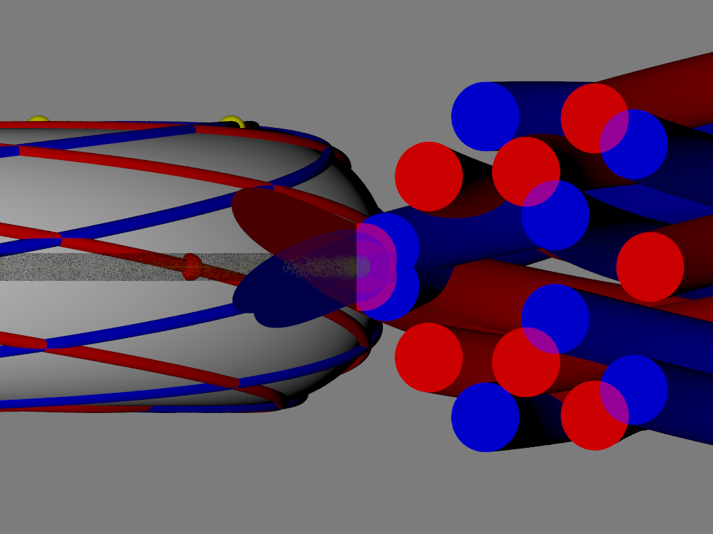

Message: <69a1ff7d$1@news.povray.org>
On 2/27/26 14:12, Bald Eagle wrote:
>> thanks.
> Thanks for taking the time to render and look it over.
> The weird thing about the shadows dead center of the image is that they are a
> dead-flat gray, and _completely blot out the tori_!
> Maybe it's just me, but that seems weird.
> - BE
Those are shapes - see the attached image where I turned the light
source 'shadowless' and added 'cutaway_textures' to the difference{}.
Rendered using my v3.8 beta 2 compile.
The only shadow issues I noticed (ignoring the center yellow shape
issue) was that your posted image had noise in the upper left of the
overall shape where my local build's render did not.
Bill P.
Download 'dupincyclide_3dprint_noshad_cutawy.png' (164 KB)
Preview of image 'dupincyclide_3dprint_noshad_cutawy.png'
