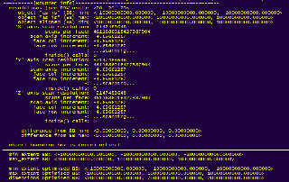

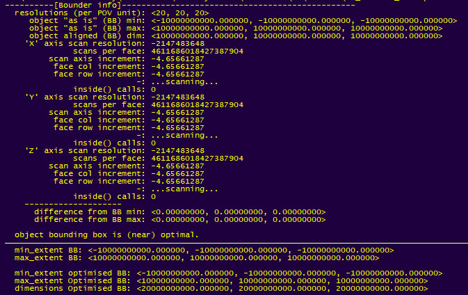

"jr" <cre### [at] gmailcom> wrote:
> ... I wrote a macro which "scans" an object's BB ...
find attached the second update of the 'Bounder'.
things have changed a little.  now, if the object's BB is found to be "(near)
optimal", the macro prints that and ends, otherwise, ie having some "slack", the
macro prints the difference lines as before, plus the optimised extents and
dimensions, as per Thomas's feedback.
also new, if "slack" is reported, two variables with the differences from the
BB's min/max extents are declared, to allow use of the info from in-scene.
after 'Bounder' has run, one can for instance:
#ifdef(Bounder_min_diff)
  // do something
#end
so.  version 3.  fingers crossed.
enjoy, jr.

The test (using version 2 of bounder.inc) for quartic objects is
interesting. Using the Lemniscate object the BB seems to be infinite and
the test is considered optimal. See image attached.
Download 'quarticbound.jpg' (174 KB)

With version 3, I get a parser error in the scene file when the object
is considered as near optimal: "Expected 'numeric expression',
undeclared 'Bounder_min_diff' found instead"
From: jr
Subject: Re: bounding box calculator
Date: 6 Nov 2019 05:15:01
Message: <web.5dc29d0734d8ef06feeb22ff0@news.povray.org>
hi,
> Op 04/11/2019 om 09:09 schreef Thomas de Groot:
> > - the test is also useful with hyperboloid, superellipsoid, and
> > isosurface objects. Quartic and parametric objects do no comply,
> > probably they are not 'solid'? I did not test this thoroughly.
I see the BB change in size when the object is aligned, no idea(s).
interesting.
regards, jr.
