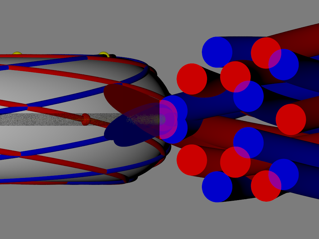

I am working on a scene to establish geometry for conversion to OpenSCAD.
I'm super close, but when I zoomed in to closely inspect how things were
positioned, I noticed that some objects simply weren't being properly lit.
Adding emission only partially remedied the situation.
The objects are all just a simple torus {} with plain rgb pigments.
But for some reason the yellow torus is the only one really affected.
Lights are just point lights.
Lit from the front with no obvious occlusion.
Adding a top light doesn't help.
The shadows are really weird too.
3.8 beta 2
Any ideas?
- BE
Download 'dupincyclide_3dprint.png' (118 KB)
Preview of image 'dupincyclide_3dprint.png'

On 2/19/26 07:05, Bald Eagle wrote:
> Any ideas?
Guesses.
Some of what I see in your image can happen when the plane of the camera
slices into shapes like the torus{}.
That 'emission 1' didn't help much and that you have some apparent
speckling looks more like solver issues - which could be related to
geometry of the scene for the image posted and/or the state of the
'solver code' itself.
Are you using an orthographic camera?
With the camera set up you have, how are you zooming?
Have you tried with both 'sturm' and not? If so, are there differences
in result?
A wilder guess. The ray->surface intersection equations for the torus
adjust each rays origin prior to creating the equation for the
solver(s). The origin adjustments are unrolled after roots are found so
as to get the real intersection positions. It's known that ray origin
adjustment works less well at larger torus dimensions once the equation
origin is beyond the first surface.
Bill P.
> > Any ideas?
> Guesses.
Could be.
The other weird thing is that the yellow torus was not only speckled - but it
was partially transparent as well.
I've seen and mentioned this before in other scenes.
Yes.  Luckily I emailed myself the scene, so I can reference it.
#declare Zoom = 0.4;
camera {
orthographic
location <IR*1.5, 0, -2*IR>
location <IR, 5*M, -2*IR>
//location <IR, 5*M, 0>
right    x*image_width/Zoom
up       y*image_height/Zoom
look_at <IR, 0, 0>
> in result?
I didn't yet - but have thought about doing so.
It's a 150-unit torus.
#declare M = 150;
#declare m = 20;
torus {M, m pigment {rgb 1} translate T_Center}
I'll try perspective and maybe sturm when I get back in.
The really puzzling thing about it, is that all of the other tori render just
fine.
- BE
> fine.
Changing to perspective helped - but there was still a thin line of cruft around
the perimeter.
Sturm didn't do much to remedy that, but shifting the camera up a little bit
did.
The shadows still look weird.
- BE

On 2/19/26 19:18, Bald Eagle wrote:
>> fine.
> the perimeter.
> did.
On the shadows.
First a disclaimer. In not completely understanding the geometry of your
scene, seeing what you see as wrong about your shadows is not completely
clear.
That said, one of the things which can happen is that the shadow test
rays can resolve to surfaces different than do the camera rays.
For example, sometime last year I posted about the sor example used in
our documentation being problematic for our solvers - especially those
in the official POV-Ray releases. There were cases there where shadow
test rays in some set ups were causing solver problems while those from
the camera were OK.
I'll also mention the 2.5 issues in the shadow cache mechanism of
official POV-Ray releases which are fixed in the yuqk fork. Those shadow
cache issues can cause strange shadow artifacts - depending on 'stuff'.
I'm busy today, but I'll put on my todo list testing with your
orthographic camera(*) and zoom set up. My generic orthographic camera
set up is somewhat different.
Aside: An interesting test would be to replace the torus{} shapes with
isosurface f_torus() shapes. The isosurface mechanism (so long as the
max gradient is large enough for all ray approaches) is often more
robust / stable with respect to resolving surfaces from varied ray
approaches.
Bill P.
Bill W, This morning I got around to running the scene you sent to me -
thanks.
I can reproduce your image with my v3.8 beta 2 - except I don't get some
noise in the shadows near the top on the left. This difference a
surprise and I'm unsure what might be the cause. Differences in compiler
settings? Differences windows to linux? Some difference in ini / command
lines settings? I don't know. I took a few shots in the dark trying to
reproduce the shadow noise without success.
When your scene is run with my current development yuqk fork, I again
get no noise on the top left (matching my v3.8 beta 2 compile), and the
yellow shape running left to right renders fine - see attached image.
So, some fix(es) in yuqk address whatever issue there is with that
particular yellow torus{}. I probably won't take the time to run down
which one(s) - it's time consuming to do.
Bill P.
> thanks.
Thanks for taking the time to render and look it over.
The weird thing about the shadows dead center of the image is that they are a
dead-flat gray, and _completely blot out the tori_!
Maybe it's just me, but that seems weird.
- BE
>> thanks.
> - BE
Those are shapes - see the attached image where I turned the light
source 'shadowless' and added 'cutaway_textures' to the difference{}.
Rendered using my v3.8 beta 2 compile.
The only shadow issues I noticed (ignoring the center yellow shape
issue) was that your posted image had noise in the upper left of the
overall shape where my local build's render did not.
Bill P.
Download 'dupincyclide_3dprint_noshad_cutawy.png' (164 KB)
Preview of image 'dupincyclide_3dprint_noshad_cutawy.png'
> Those are shapes
Oh.   :D
Hoping my newest code fixes all of that wrongly oriented stuff.
Thanks for looking again.
