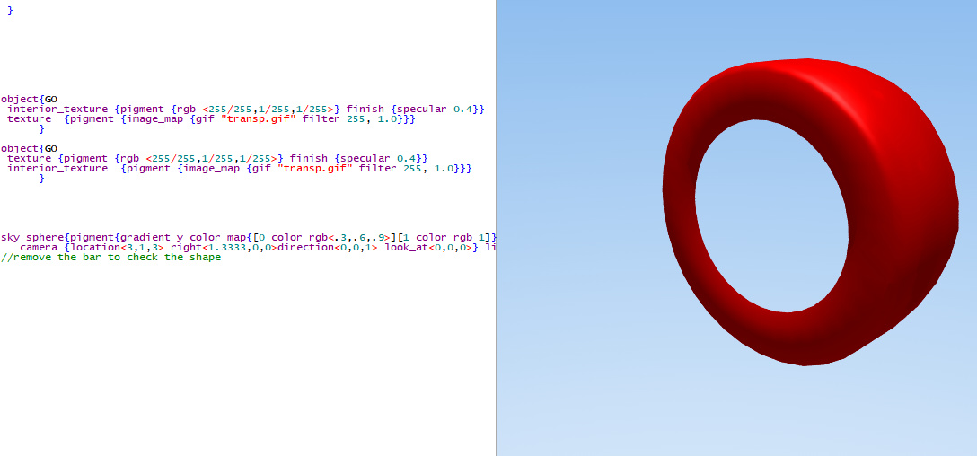

Bug hacked?
old sprites concept? I'm under no illusions, I'll do more tests, but in this way
I don't see the bug anymore
Download 'clipboard01.jpg' (122 KB)
Preview of image 'clipboard01.jpg'

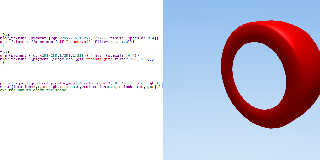

Le 2023-11-24 à 16:19, GioSeregni a écrit :
> well, I have a little question because I have often read about "artifact" on
> sooth_triangle but I don't understand. It is very difficult for me to translate
> technical language and figurative sayings. Now I have started translating the
> include files of my PovRay library that I interface with CAD, triangle to
> smooth_triangle.
> This wheel has black corners (two), on the right. Are these common artifacts, or
> can I fix them?
> Thanx in advanced!
> G.
That can happen when you can see the triangle but it's normal is
pointing away from the camera.
Try rotating the tire along it's axis.
> > > > "Bald Eagle" <cre### [at] netscapenet> wrote:
> > > > > And if you DO see red there, then try moving the camera around, and viewing
it
> > > > > from different angles - because it may just disappear and pop up in
different
> > > > > areas.
> > > > It seems that they always arise on the
> > > > perimeter of the volumes (in positions tangential to the cone of vision)...
> > > Yes, that is where those artifacts sometimes appear on a smooth-triangle object.
> > > I think it also depends on the lighting angle, and maybe even the size of the
> > > triangles.
> > > What you are seeing is a known effect of raytracing the smooth normals when they
> > > are viewed at that raking angle. (I thought that there was a short technical
> > > explanation of this in the documentation, but I cannot find it.) The camera is
> > > picking up the unlighted (black) interior of the object.
> > > If I make a low-rez height_field and add the 'smooth' keyword, the same thing
> > > happens. The interior_texture trick is one way to try and make these artifacts
> > > less noticable. Or try adding the 'double_illuminate' keyword to the object. If
> > > I recall, this was a recommended 'fix' for the problem. It seems to work most of
> > > the time, but not in every situation.
> > Ok, thank! I am working on .. it does not seems by light position, but by the
> > angle between WP and smooth_triangle (s) ...
> > Many thanks again!
> > G.
> Bug hacked?
WOW!
right no trick
left the concept ... SHAPE-in-out XOR SWAPSHAPE-out-in
Download 'clipboard01.png' (198 KB)
Preview of image 'clipboard01.png'

Even better :
interior_texture{pigment{rgbt 1}}
or
interior_texture{pigment{rgbf 1}}
That way, no need to use any image file.

> Even better :
> or
Well , I will check... anyway the gif image is only a transparence...
but I call the object twice, swapping inside/outside
Do you mean the same thing? To understand I would have to see your code on
pigments
TX!
G.

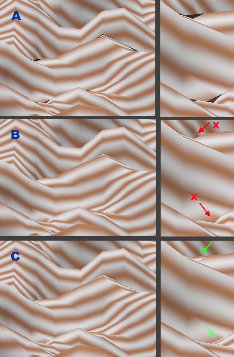

From: Kenneth
Subject: Re: Smooth level for smooth_triangle.
Date: 25 Nov 2023 17:10:00
Message: <web.65626f7d84c692a39b4924336e066e29@news.povray.org>
> Bug hacked?
> this way I don't see the bug anymore
Using a transparent texture like that is very clever! However, it actually
*removes* the offending triangles... that is, it makes them invisible (if that
matters.) I had to test it to see. You might want to examine your renders to see
if that happened.
The attached image is my height_field again; close-ups are on the right side:
A-- the artifacts
B-- with    interior_texture{pigment{rgbt 1}}.  The artifact triangles are
missing (invisible).
C-- with    interior_texture{-- same as exterior--}
but with   finish{--ambient or emission value--} to try to match it.
The triangles are visible.
The scheme of using the same interior_texture as the outer one still looks
better, to my eyes.
[code taken from your image]
object{GO
interior_texture{pigment{rgb...}...
texture{pigment{image_map{gif "transp_GIF".gif...  [or  pigment{rgbt 1} ]
Although this scheme might appear to work for your model, it has a  problem: The
interior_texture is the 'real' one, but it does not respond to the usual
'exterior' lighting in a scene because it is actually on the INSIDE  surface of
the mesh. Only ambient or emission in its finish{...} is of any use, which does
not look very good-- at least for  my own height_field.
Download 'artifact_comparison_kw.jpg' (129 KB)
Preview of image 'artifact_comparison_kw.jpg'
> better, to my eyes.
> object{GO
Unfortunately I noticed that my system still has artifacts that I didn't see.
However, I noticed that in my test models they are less evident because those on
the edges of the shape generally disappear (which I believe are faces tangential
to the vector starting from the point of view). I haven't tried playing with f
and t yet... I'll try tomorrow. Now I'm importing colors from STL to bring them
grouped onto distinct meshes

Just something like this :
First instance become
interior_texture{pigment{ Something }}
The other become
