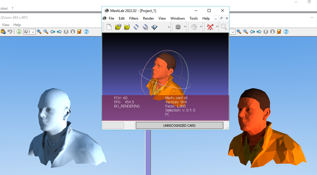

My code is already working from STL to POV even with the color subset of STL.
In fact I have to add the surface calculation to the loops from triangle to
smooth_triangle, I'll take a look at your system. But first I also want to
translate the color, as I already do with the triangles, dividing groups of
differently colored meshes. This way my translator will also become faster
because the loops are compact and short on small meshes.
(between different colors I don't want smooth).
In the center STL, on the left the current smooth routine, on the right the
simple triangle mesh. Thank you!

From: GioSeregni
Subject: Re: Smooth level for smooth_triangle.
Date: 21 Nov 2023 08:25:00
Message: <web.655caf7584c692a35464b73e59126100@news.povray.org>
> I tried a search of the NG to see what else there might be, these were the only
> 2 so far to catch my eye.
> Maybe some small thing in there might trigger an idea, yet untested.
> Warp:
> https://news.povray.org/3cd536d5%40news.povray.org
> jceddy:
http://news.povray.org/povray.general/thread/%3Cweb.442a6fe16260549766ffc7a50@news.povray.org%3E/
> - BW
Tx Jr and BW for the links, I use exactly the average..
warning about colors in STL
They aren't true color
I use this code by STL (subset of colors)  to POV (truecolor)
r=STLface.descriptor AND 31744
r=r SHR 10
r=r*8
g=STLface.descriptor AND 992
g=g SHR 5
g=g*8
b=STLface.descriptor AND 31
b=b*8
POV_COLOR=b+(g*256)+(r*65536)
NOTE: this is my struct for STL's face
TYPE STL
 header    As String * 80
 numfacets As Long  '4 b then -> loop
 nx        As Single   '4 b
 ny        As Single
 nz        As Single
 x0        As Single
 y0        AS Single
 z0        As Single
 x1        As Single
 y1        As Single
 z1        As Single
 x2        As Single
 y2        As Single
 z2        As Single
 descriptor As Short '2 b <--- end loop
END TYPE
DIM STLface AS STL
