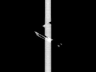

In the attached multi-image, image, the left column is the frame 1 set
up, and the right column frame 2's. In all results the prism is using
'hollow off' and a 'photons 'target collect off reflection on refraction
on } block is used for the media-box.
The top row shows only the scattering media result (no photons).
In the middle row both the scattering and photons contributions.
In the bottom row the scattering calculation is dropped by using 'media
interaction off' in the light_source{} block.
Yes! There should be some refraction/refection contributions looking
into the top of the prism coming from the media photons outside the
prism. We can get those back by using 'hollow on' - as you originally
did - for the prism while still using 'media_interaction off' with the
light source. See the larger of the attached images.
