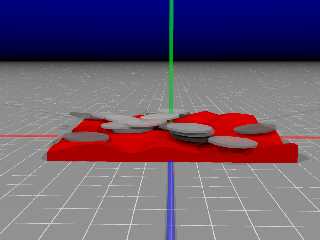

I wrote the code based on the letter stacking code in libcollide.inc and
debugged it, and added the grid generation piece to my libmesh.inc library.
Here are the results of repeatedly adding 20 discs to the same uneven surface
using the algorithm.  I think it does pretty well and it's actually quick enough
that you could run it during rendering, but I kept the option to write the
transforms to a file so you can pre-create them.
More testing to do...
-- Chris -R
Download 'libcollide_test.png' (149 KB)
Preview of image 'libcollide_test.png'
