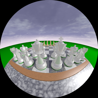

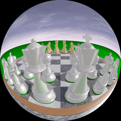

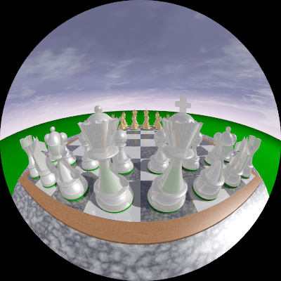

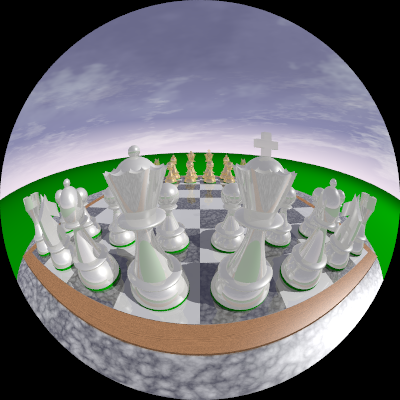

Attached various fisheye renderings.
Download 'equisolid.png' (162 KB) Download 'fisheye.png' (158 KB) Download 'orthographic.png' (171 KB) Download 'stereographic.png' (151 KB)
Preview of image 'equisolid.png'
Preview of image 'fisheye.png'
Preview of image 'orthographic.png'
Preview of image 'stereographic.png'
