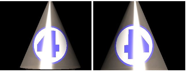

I am working on a model of the Fantastic Four rocket that was used in
the 60's cartoon.  I have made the model and am happy with it.  I am now
trying to put the '4' decal on the nose cone.  I have an image map of
the 4 and have placed it in the correct position.  When I move the
camera to the other side of the nose, however, the image is shonw as
reversed.  I have searched this newsgroup on image maps and found out
how to make a cube with 6 different maps on all of the faces.  I would
like to know how to keep this one map from bleeding through to the other
side.  I need to put the same image on the other side in the correct
orientation.
Attached is a picture of the front and back of the cone.  Any help would
be greatly appreciated.
Brian Mason
bri### [at] gvnnet
http://www.gvn.net/~brian448/
Download 'ffrocket.jpg' (19 KB)
Preview of image 'ffrocket.jpg'

  I recommend you use two cones that have been clipped in half with a plane.
Apply the image map to one and then combine the two halves together in a
union.
Ken Tyler

   You must absolutely LIVE on this news-server :)   Talk about your
quick turnaround times!
I'll give it a shot.  Sounds like it will work.
