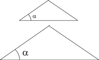

Suppose you look the surface of a heightfield not from above but from
the side
(I hope you understand). Suppose that the surface is like a triangle
(this
could be anithing else it is just a pedagogic example :)), like in the
following
image (sorry for this tiny binary but I think it is important). Aplha is
the
slope (or tan(alpha) is you prefer). If I scale my triangle, alpha don't
change.
The length of the side change, so my heightfield will be bigger, but the
slope of
any point of the surface doesn't change!
This behavior must be the same for normal in texture block.
Now if Megapov already do this like this, so I am sorry for this spam!
Fabian.

:>   A normal pattern actually simulates a heightfield.
: Am I missing something here ?
: As far as I know a normal has no releationship to a height field in any
: way what so ever. The models are entirely different.
  I think that you are a bit confused... :)
  The normal modifier indeed simulates a heighfield by just changing the
normal vectors like a heightfield would (but it doesn't change the actual
shape of the object). This affects the shading of the surface. If shadows
are not calculated, then the shading of a heightfield would be identical
to the shading of an equivalent normal modifier (at least if we are looking
from up).
  The idea behind the normal modifier is that when the changes in the shape
of an object is small enough (like a rough surface) we only need the shading
and the actual shape is not important. The normal modifier is cheaper to use.
: When you apply a normal to a surface it's properties are controlled
: explicitly by two parameters. The first is the float value after the
: pattern type i.e. normal { bumps 1 } which sets the normal depth. The
: second is the scale of the pattern which only effects the scale of the
: pattern itself and not the depth of the normal pertubation. Scaling the
: normal will not affect the depth of the normal pertubation and was never
: intended to. It may effect the depth of the pattern but it will not
: change the depth or height of the pertubation itself. If you want this
: value to change then you must change the float value after the pattern
: type and not rely on the scale value to do this for you. Any other model
: for the normal would not be correct.
  Here you are completely right.
  As I said, scaling uniformly an object does not change the slope in any
part of its surface. Thus, the slope of the normals stay unmodified.

Here is another example:
suppose you have a heightfield. Now close to it, you take a piece of
plane and you play with normal (you look from above). After lot of work,
your piece of plane look exactly like the heightfield (of course if you
look from the side, you see the elevation of the heightfield but
the plane is, of course, still flat!). You cannot say which is the
heightfield. You calculate one image, say height.tga. Now if you scale
both the heightfield and the piece of plane by the same factor x, and
if you modify the camera in a proper way, the piece of plane will still
look exactly like the heightfield. Moreover, if you calculate the image,
say
height2.tga, you get the same image than height.tga (perhaps if one
choose
a good heightfield (simple), it is possible to get with normal the same
thing. Atfer this one make the test with scaling.
This could be a interesting test for MegaPov)
Fabian.

I haven't tried with megapov, but what you're saying is that in
standard pov, the bug is with normal_maps... Well it isn't: I've just
tried rendering a file with two identical normals, one inside a
normal_map and the other outside and sure enough when I scale the whole
scene up, the one inside the normal_map doesn't change while the one
outside looks completely different...
	Now, here's how I understand things: when you scale a height_field by a
constant value (say 5), what pov does is promote the 5 to <5, 5, 5>
therefore the height_field is 5 times deeper as well as 5 times wider
(which keeps the slope unchanged, I agree). But when you scale a normal
by 5, the way pov does it is equivalent to scaling by <5, 1, 5> (I
haven't looked at the code, so I'm not sure why it's that way, but
that's what the result look like) which does change the slope...
	Bottom line: I believe that your reasoning is sound, but that your
conclusion is false: if Nathan has changed it so that it always behaves
as if it was in a normal_map, then he has indeed the right of it.
		Jerome
PS: If anybody is interested in wild speculations, here's how I would
explain the bug in the official version. Keep in mind that I haven't
looked at the code so this might be completely stupid...
I'll assume we're speaking about a plane { y, 0 } with a normal. When
you scale it by 5, it gets promoted to <5, 5, 5> but the y component
doesn't matter since the plane is flat. Then pov computes the normals:
it evaluates the pattern to determine the relative amount of
perturbation, then uses the depth given as a float parameter to
determine the total amount of perturbation. The problem is that the
values returned when evaluating the pattern don't take scale into
account (the scale only affects the point at wich the pattern is
evaluated, *not* the returned value) and this value is akin to the depth
of the height field so it should have been scaled too... That's what I
mean when I say that the result is similar to a scale <5, 1, 5> as far
as the normal is concerned.
