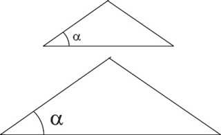

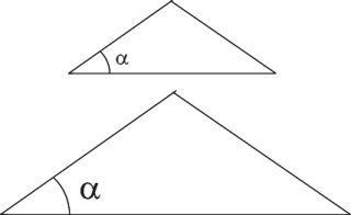

Suppose you look the surface of a heightfield not from above but from
the side
(I hope you understand). Suppose that the surface is like a triangle
(this
could be anithing else it is just a pedagogic example :)), like in the
following
image (sorry for this tiny binary but I think it is important). Aplha is
the
slope (or tan(alpha) is you prefer). If I scale my triangle, alpha don't
change.
The length of the side change, so my heightfield will be bigger, but the
slope of
any point of the surface doesn't change!
This behavior must be the same for normal in texture block.
Now if Megapov already do this like this, so I am sorry for this spam!
Fabian.
