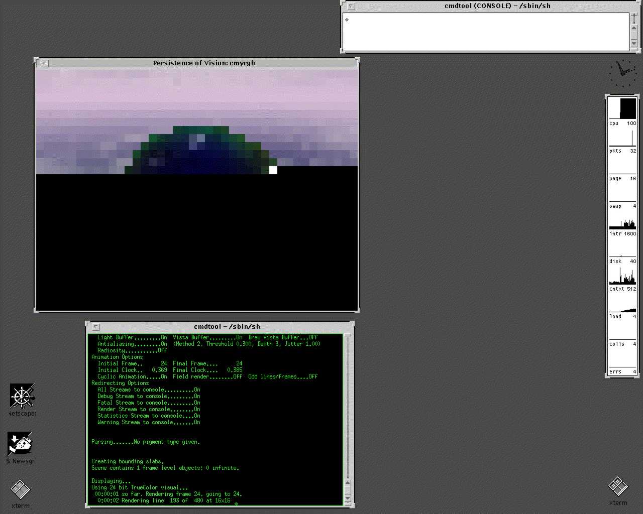

From: Dennis Clarke
Subject: x-povray 3.1g broken after make clean ...
Date: 7 Aug 1999 00:47:10
Message: <37ABBA48.E4B78C63@interlog.com>
$ make clean
$ make xwin

Seems to be a bit of a filesize difference between this compile and my last one.
I'll render skyvase.pov with +D option and see what I get ...
$ find . -name x-povray -print
./povray/source/povray31/source/unix/x-povray
$ find /usr/local/povray31 -name skyvase.pov -print
/usr/local/povray31/scenes/advanced/skyvase.pov
$ ./povray/source/povray31/source/unix/x-povray
+I/usr/local/povray31/scenes/advanced/skyvase.pov +O./povray/bench/skyvase.tga
+W640 +H480 +FT +A0.300 +AM2 +R3 -J +Q9 +V +GA +L/usr/local/povray31/include +X
+D

From: Dennis Clarke
Subject: Pov-Ray 3.1e and 3.1g lock up with my scene file ... ?!
Date: 7 Aug 1999 02:02:56
Message: <37ABCBD6.4A93481C@interlog.com>
Here is a screen shot from my workstation ... it pretty much shows what happens
when 3.1e attempts to render my scene file.  Sory about the size but I made this
as small as possible.  Will anyone be interested in attempting to render this
image?  I'd like to know that I wasn't the only one that is having this problem
Dennis Clarke
dcl### [at] interlogcom
System specifics : Sun Ultra 10 Creator 3D Solaris 7 256Mb RAM ...
Download 'lockup.jpg' (98 KB)
Preview of image 'lockup.jpg'
From: Ken
Subject: Re: Pov-Ray 3.1e and 3.1g lock up with my scene file ... ?!
Date: 7 Aug 1999 02:07:26
Message: <37ABCCC1.3F59199F@pacbell.net>
Email it to me and I will try it on the v3.1g windows platform for you.
Ken Tyler
Older   Links Page: http://home.pacbell.net/tylereng/links.htm
Updated Links Page: http://home.pacbell.net/tylereng/bkmrk999.htm

From: Ken
Date: 7 Aug 1999 04:12:28
Message: <37ABEA05.68E9E27F@pacbell.net>
> > Ken Tyler
> OK ... good luck and here it is ...
  Ok !... It took me a while but I think I have isolated the problem you
are having to one component in your blob construct. If you remove or
reduce the amount of reflection you have specified the render time goes
back down to an acceptable level. I believe you are simply experiencing
internal reflections which causes the program to send out a lot more
rays to calculate the object. By removing the reflection component it
only has to work on the transparent surfaces and the specular and phong
highlights you have specified.
 It's up to you if you want to live with these long render times but
personally I would either seriously reduce the reflection to something
like 0.05 or less or eliminate it completely. Any other changes I attempted
had little or no effect on the render time but turning off the reflection
was immediately noticeable. I also noticed little difference as to image
quality with it tuned off.
P.S. I never really hit a point where my system was "locked up". It simply
started taking a long time to render once I got to the second frame of the
animation. As the second frame progressed I could watch the pps counter
drop at a visible rate so eventually it might have appeared to have locked
up but of course it really was working only in slow motion.
I have a pentium 200 running win 98 with 128 megs of ram.
Ken Tyler

From: Dennis Clarke
Date: 7 Aug 1999 15:58:43
Message: <37AC8FE7.48E0C2FD@interlog.com>
> > > Ken Tyler
There must be a big difference between your Win98 version of POVRay and my unix
build because even after I commented out the reflections in the blob components
I still had a system that looks like its locked up.  ITs not locked up, it just
isnt doing anything meaningful.  Here is a truss of the process running, if you
can call it that :
$ ps -ef | grep povray
 dclarke  3144  2492 99 15:43:15 pts/7    6:34 /usr/local/povray31/x-povray
+I./cmyrgb.pov +O../../output/cmy_.tga +W320 +H240
 dclarke  3181  3129  0 15:50:13 pts/6    0:00 grep povray
$ truss -t!ioctl,time -p 3144
    Received signal #20, SIGWINCH [default]
    Received signal #15, SIGTERM [caught]
      siginfo: SIGTERM pid=3186 uid=1001
sigaction(SIGTERM, 0xFFBD4DD0, 0xFFBD4E50)      = 0
sigaction(SIGINT, 0xFFBD4DD0, 0xFFBD4E50)       = 0
sigaction(SIGPIPE, 0xFFBD4DD0, 0xFFBD4E50)      = 0
sigaction(SIGFPE, 0xFFBD4DD0, 0xFFBD4E50)       = 0
write(2, "\n G o t   1   S I G T E".., 15)      = 15
setcontext(0xFFBD5030)
sigaction(SIGTERM, 0xFFBD9EA0, 0xFFBD9F20)      = 0
sigaction(SIGINT, 0xFFBD9EA0, 0xFFBD9F20)       = 0
sigaction(SIGPIPE, 0xFFBD9EA0, 0xFFBD9F20)      = 0
sigaction(SIGFPE, 0xFFBD9EA0, 0xFFBD9F20)       = 0
write(2, "\n G o t   2   S I G T E".., 15)      = 15
setcontext(0xFFBDA100)
      siginfo: SIGTERM pid=3196 uid=0
sigaction(SIGTERM, 0xFFBD8768, 0xFFBD87E8)      = 0
sigaction(SIGINT, 0xFFBD8768, 0xFFBD87E8)       = 0
sigaction(SIGPIPE, 0xFFBD8768, 0xFFBD87E8)      = 0
sigaction(SIGFPE, 0xFFBD8768, 0xFFBD87E8)       = 0
write(2, "\n G o t   3   S I G T E".., 15)      = 15
setcontext(0xFFBD89C8)
        *** process killed ***
    which is to say that I needed to su root to kill the process.  Other than a
lot of calls to time() and ioctl() there is really only the occasional write()
to the terminal.  Once my render hits line 111 of 240, everything just stops.
Dennis Clarke
ps: How did I build this 3.1e version? see
http://www.interlog.com/~dclarke/povray/povray.html
Download 'smime.p7s.dat' (3 KB)
