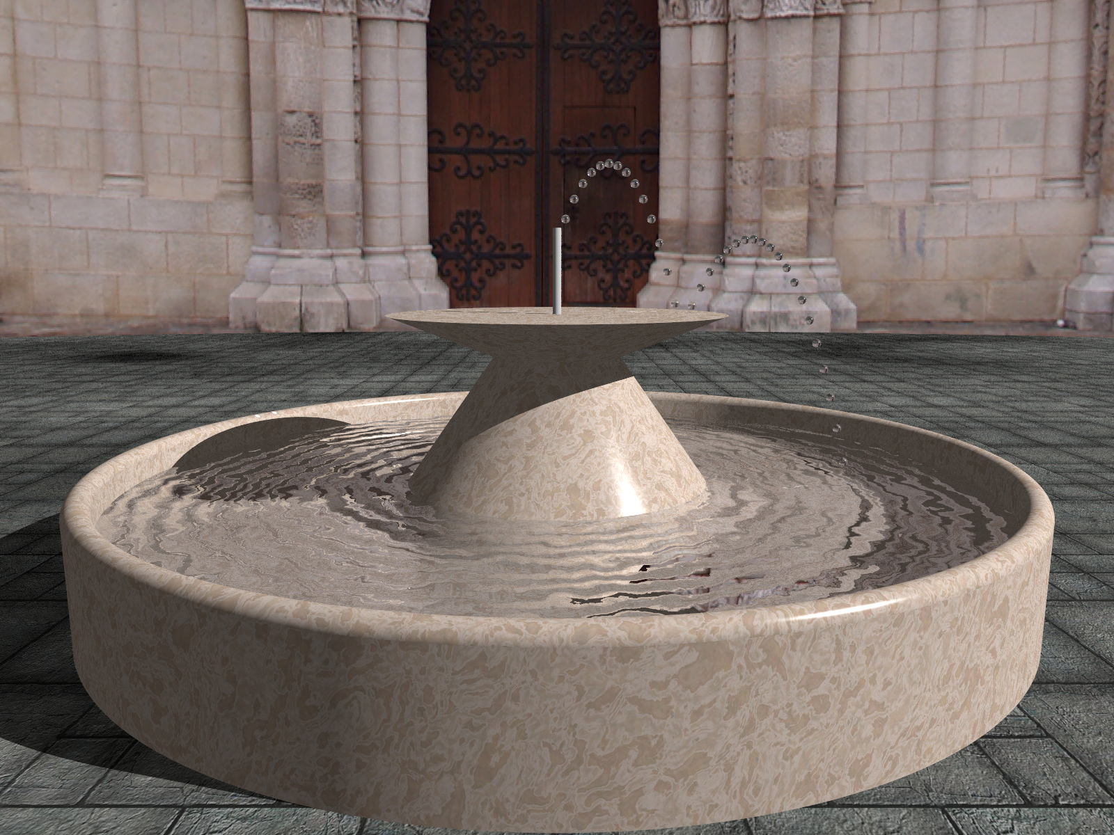

Him I am trying to replicate this water droplets all around the tap, so maybe a
series of droplets every 12 or 24 degrees around z axis. How should I do. that?
I know it is a beginner trick, but I am trying different #while sentences and it
doesn't seem to work out. Could somebody help me? Here is the code I am using to
achieve the droplets look like a trajectory.
Thanks in advance for any help,
// FUENTE SUPERIOR
#declare posX = 0.02;
#declare posY = 0.82;
#declare dy = 0.055;
#declare posZ=0;
#declare posZ= <0,0,posZ+12>;
    #while (posX < 0.3)
    sphere {
    <posX,posY,0>, 0.01
    material { agua }  }
    #declare dy = dy - 0.01;
    #declare posX = posX + 0.02;
    #declare posY = (posY + dy);
    #end

I think if you look at code used to model the physics of a falling object, or
better yet, a bouncing ball - you will get the deceleration on the upward
"bounce" and the acceleration on the subsequent fall.
Attached, find a scene I wrote to do the bouncing ball, hope it helps - ask if
you have any questions.

#declare Rotation=0;
#declare Rotation_angle=12;
#while (Rotation < 360)
     #while (posX < 0.3)
         sphere {
         <posX,posY,0>, 0.01
         // material { agua }
         rotate<0,Rotation,0>
     #end
     #declare Rotation = (Rotation + Rotation_angle);
#end

Thank you so much m@b, that was exactly what I was looking for. What if I wanted
to continue drawing my droplets in the lower level of the fountain? Where should
I declare the distance from the Y axis so that the droplets appear as a
continuation of the upper level?
Thank you in advance for any help

You could just add a second sphere and translate it before rotation:
     #while (posX < 0.3)
         sphere {<posX,posY,0>, 0.01 pigment{rgb<0,1,0>}
       rotate<0,Rotation,0>}
         sphere {<posX,posY,0>, 0.01 pigment{rgb<0,0,1>}
translate<0.2,-0.3,0> rotate<0,Rotation,0> }
     #end
#end
