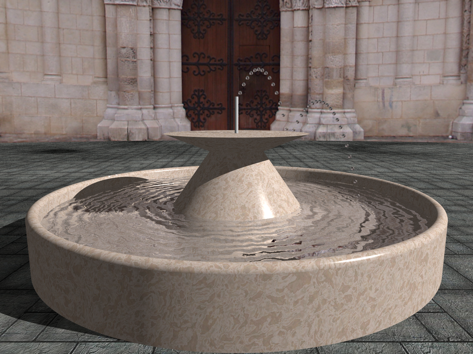

Him I am trying to replicate this water droplets all around the tap, so maybe a
series of droplets every 12 or 24 degrees around z axis. How should I do. that?
I know it is a beginner trick, but I am trying different #while sentences and it
doesn't seem to work out. Could somebody help me? Here is the code I am using to
achieve the droplets look like a trajectory.
Thanks in advance for any help,

From: Bald Eagle
Subject: Re: Scene enquiry
Date: 19 Oct 2022 13:25:00
Message: <web.635032bd984692c41f9dae3025979125@news.povray.org>
I think if you look at code used to model the physics of a falling object, or
better yet, a bouncing ball - you will get the deceleration on the upward
"bounce" and the acceleration on the subsequent fall.
Attached, find a scene I wrote to do the bouncing ball, hope it helps - ask if
you have any questions.

From: santividal
Date: 20 Oct 2022 06:00:00
Message: <web.63511b77984692c4dd71315024a2c7df@news.povray.org>
Thank you so much m@b, that was exactly what I was looking for. What if I wanted
to continue drawing my droplets in the lower level of the fountain? Where should
I declare the distance from the Y axis so that the droplets appear as a
continuation of the upper level?
Thank you in advance for any help
You could just add a second sphere and translate it before rotation:
#declare Rotation=0;
#declare Rotation_angle=12;
#while (Rotation < 360)
     #declare posX = 0.02;
     #declare posY = 0.82;
     #declare dy = 0.055;
     #while (posX < 0.3)
         sphere {<posX,posY,0>, 0.01 pigment{rgb<0,1,0>}
       rotate<0,Rotation,0>}
         sphere {<posX,posY,0>, 0.01 pigment{rgb<0,0,1>}
translate<0.2,-0.3,0> rotate<0,Rotation,0> }
         #declare dy = dy - 0.01;
         #declare posX = posX + 0.02;
         #declare posY = (posY + dy);
     #end
     #declare Rotation = (Rotation + Rotation_angle);
#end
