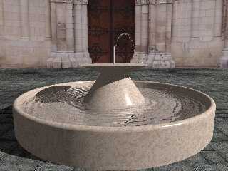

Him I am trying to replicate this water droplets all around the tap, so maybe a
series of droplets every 12 or 24 degrees around z axis. How should I do. that?
I know it is a beginner trick, but I am trying different #while sentences and it
doesn't seem to work out. Could somebody help me? Here is the code I am using to
achieve the droplets look like a trajectory.
Thanks in advance for any help,
// FUENTE SUPERIOR
#declare posX = 0.02;
#declare posY = 0.82;
#declare dy = 0.055;
#declare posZ=0;
#declare posZ= <0,0,posZ+12>;
    #while (posX < 0.3)
    sphere {
    <posX,posY,0>, 0.01
    material { agua }  }
    #declare dy = dy - 0.01;
    #declare posX = posX + 0.02;
    #declare posY = (posY + dy);
    #end
Download 'fuenteee.png' (2682 KB)
Preview of image 'fuenteee.png'

From: santividal
Subject: Re: Scene enquiry
Date: 20 Oct 2022 06:00:00
Message: <web.63511b77984692c4dd71315024a2c7df@news.povray.org>
Thank you so much m@b, that was exactly what I was looking for. What if I wanted
to continue drawing my droplets in the lower level of the fountain? Where should
I declare the distance from the Y axis so that the droplets appear as a
continuation of the upper level?
Thank you in advance for any help
You could just add a second sphere and translate it before rotation:
#declare Rotation=0;
#declare Rotation_angle=12;
#while (Rotation < 360)
     #while (posX < 0.3)
         sphere {<posX,posY,0>, 0.01 pigment{rgb<0,1,0>}
       rotate<0,Rotation,0>}
         sphere {<posX,posY,0>, 0.01 pigment{rgb<0,0,1>}
translate<0.2,-0.3,0> rotate<0,Rotation,0> }
     #end
     #declare Rotation = (Rotation + Rotation_angle);
#end
