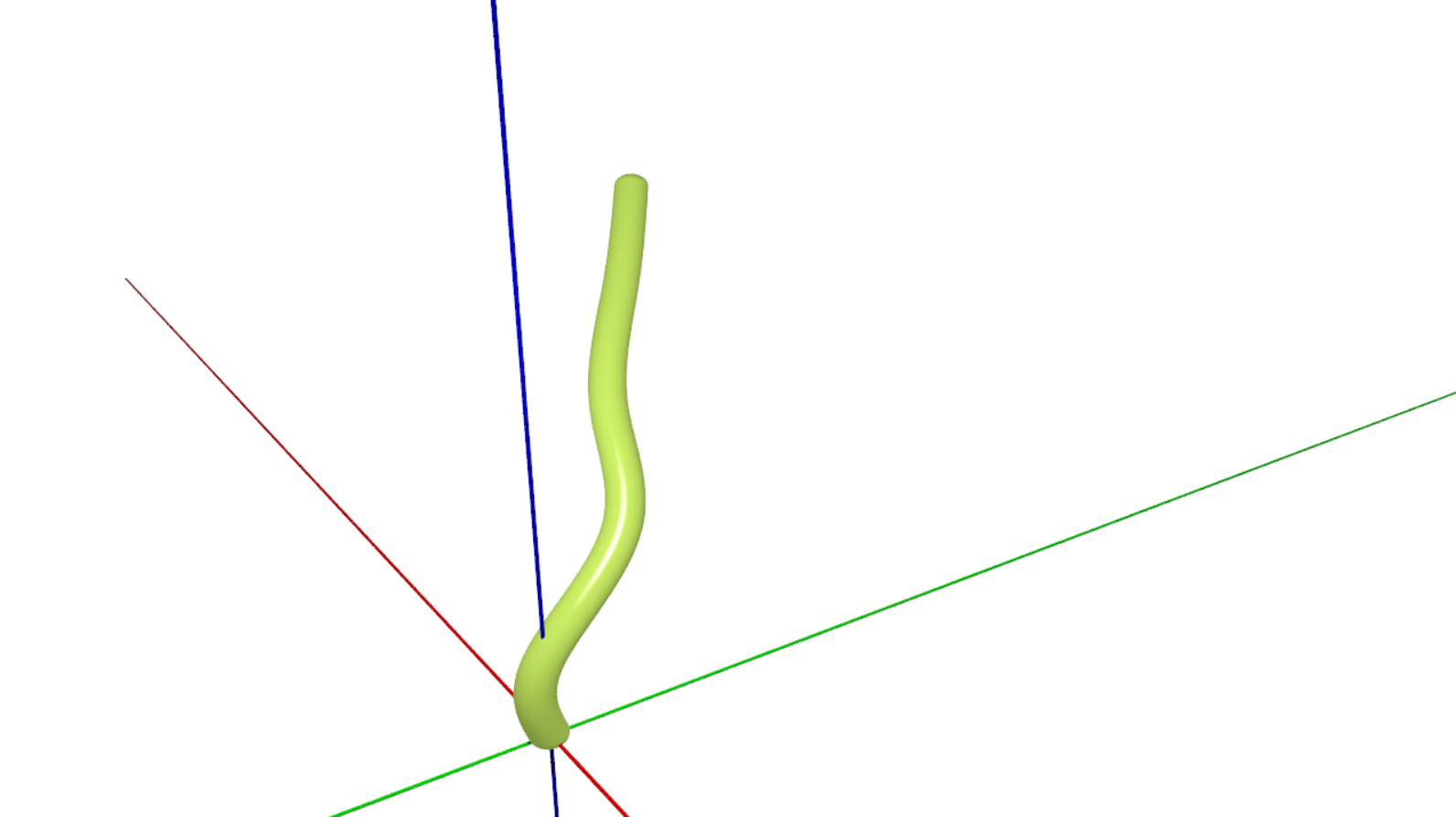

Hello everyone,
I am trying to fix this problem with my sphere sweep object as mentioned in the
subject. I am not sure if it has to do with the camera positioning or some other
setting.
I have attached the code and corresponding rendered image.
If you look at the base of the object and compare it with the tip, you will
notice that the tip appears to be thinner than the base, any suggestion on how
to fix this problem would be very helpful.
Thank you.

hi,
"Aj" <nomail@nomail> wrote:
> Hello everyone,
> I am trying to fix this problem with my sphere sweep object ...
two things I can think of:
  (a) use an orthographic type camera.
  (b) ensure the points lie in a plane wrt perspective camera.
regards, jr.

Op 23-9-2022 om 20:39 schreef jr:
> hi,
>> Hello everyone,
I agree with jr. I think this is a perspective "problem" as I do not
really "see" the sphere sweep getting thinner.
