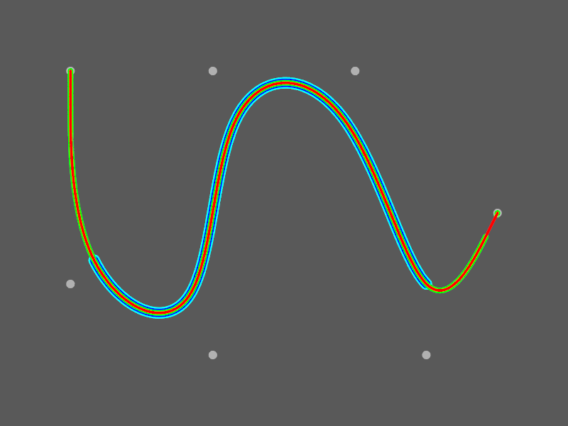

Ok. I did the same test as you. It seems to be b-splines with a closed knot
vector. Their order is 4, i.e. 3rd degree (as you found) plus 1.
> I have a very poor understanding of what is going
> on mathematically, but I do know that b_spline is not a Bezier curve.
As Bill mentioned; B-spline curves are a superset of Bezier curves.
> I found the Wikipedia article quite confusing, especially since all of
> the illustrations have the curves intersecting the endpoints, yet de
> Boor's algorithm, which the article links to, does not produce this
> result.  I know that Bezier curves are related to B-splines, but I
> haven't figured out how.
To make B-splines intersect the endpoints, you can use open knot vectors.
Alternatively you can repeat the endpoints. To see how to do this,
have a look at the source code below and the attached image.
The file NURBS_29.inc in below can be found here:
http://news.povray.org/povray.binaries.scene-files/thread/%3Cweb.4c327e199f459e99c734aecd0%40news.povray.org%3E/

Tor Olav
http://subcube.com
https://github.com/t-o-k
Download 'b_spline_sphere_sweep.png' (33 KB)
Preview of image 'b_spline_sphere_sweep.png'

> > Or is it just trial and error? Can someone please help me to get the proper
> > camera setup so as to obtain the figure attached:
> The points in your sphere_sweep don't plot the figure in the screen
> shot, the points form a more or less straight line in the z direction.
> (1.png) (Points 5 & 6 are the same.)
> Looking again at the screen shot, I notice that the 3 axes are at
> different scales. If I apply scaling and rotation to the points I can
> get something like your figure. Scale = <200,10,1> rotate<0,90,0> (2.png)
> Note that I have moved the camera to <0,0,-200>, looking at <0,0,0>. I
> find it easier to keep track of x,y,z if the camera is in the minus z
> position.
> If you want a point for the camera to look at, you can find the mean
> center of your plot thus:
>   #declare Thing_max = max_extent(Thing);
>   #declare Thing_min = min_extent(Thing);
>   #declare Thing_centre = (max_extent(Thing) + min_extent(Thing))/2;
> (Red sphere)
> #include"colors.inc"
>   camera {
>      //location <-0.0872 , -1.8850 ,   4.8301 >*3.5
>      location <0,0,-200>
>      look_at <0,0,0>
>      angle 22
> light_source { <100,100,-100>  color rgb<1,1,1> }
> background {color rgb<0.5,0.5,0.5> }
> #declare Scale = <200,10,1>;
> //#declare Scale = <1,1,1>;
> #declare P01 = Scale*< 0,         0,         -20>;
> #declare P02 = Scale*< 2.583e-09,-2.7093e-08, 3>;
> #declare P03 = Scale*< 0.075646, -0.91834,    8.9288>;
> #declare P04 = Scale*< 0.076898, -2.3756,    14.7492>;
> #declare P05 = Scale*<-0.15231,  -4.2038,    20.4593>;
> #declare P06 = Scale*<-0.15231,  -4.2038,    20.4593>;
> #declare Thing = union{
>      sphere{P01 0.9 pigment{rgb<0,1,0>}}
>      sphere{P02 0.9 pigment{rgb<0,1,0>}}
>      sphere{P03 0.9 pigment{rgb<0,1,0>}}
>      sphere{P04 0.9 pigment{rgb<0,1,0>}}
>      sphere{P05 0.9 pigment{rgb<0,1,0>}}
>      sphere{P06 0.5 pigment{rgb<0,1,0>}}
>          sphere_sweep {
>           //b_spline
>           linear_spline
>           6,
>               P01,0.5,
>               P02,0.5,
>               P03,0.5,
>               P04,0.5,
>               P05,0.5,
>               P06,0.5
>           tolerance 0.1
>           texture{ pigment{ color rgb<0.69,0.99,0.15>}
>            finish { phong 1
>             ambient 0.3
>           //scale<2,2,0.35>   rotate<-90,0,0>  translate<0,-2,3>
> //rotate<0,90,0>
> rotate<-90,0,0>
> sphere{Thing_centre, 1.5 pigment{rgb<1,0,0>} rotate<0,360*clock,0>}
> //box{Thing_min, Thing_max pigment{rgbt<1,0,0,0.8>}
> object{Thing rotate<0,360*clock,0>}
