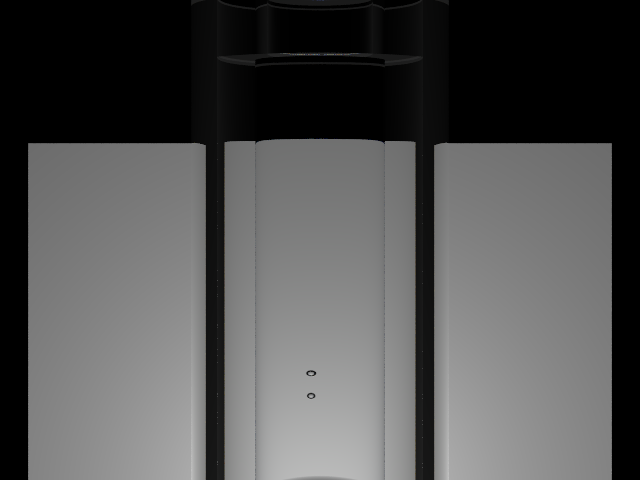

Hello Forum,
I have been beating my head against an issue in the rendering of scene.   I have
bubbles entrained in a gel, encased in a glass tube.  This is then surrounded by
water, and another clear cylinder containing the water.  I have an area light
backlighting this setup and a camera looking directly through the setup into my
backlight.
When I first rendered my setup, everything was looking good, and so I decided to
run it as an animation, rotating the bubbles around Y axis.  However, when I ran
the animation, the boundary between the glass and water appeared to be speckled,
which immediately made me think of an overlapping surface issue.  I addressed it
by adding an "epsilon" to the radius of my water cylinder's inner surface and
ran it again.  While the speckled surface issue was resolved, a large portion of
my cylinder is being rendered as a dark region, and this region will not go away
no matter what I do.
I have tried repositioning my light, resizing my light, playing with the epsilon
between the water and glass definition, increasing the max_trace_level, and with
the material characteristics of the glass.  In all cases, there seems to be a
new dark region that obscures the outer edges of my gel region.  I think this
of the glass closest to the camera, as the dark region obscures bubbles within
the gel region.
included my code below as I can only attach a single file.
Can anyone help me troubleshoot this issue?
Thank you all for your support and insights!
Sincerely,
Bubble_person
Script Below
You can attach more than one file if you use a newsreader like Thunderbird.
You can also post your scene in the scene files area with a link to it here, or
just post twice - once with the render illustrating your problem, and again with
your scene file as an attachment.
I haven't done a _lot_ with your file, but I just played around with
restructuring some things and see what was where.
Take a look through what I did - I have a #switch block to use a top-down view
with simple textures to get a clear look at your objects, and did some other
things with an array and a macro for your bubbles.
Just change the value of "Render" to "Setup" or "Scene" to see how that works.
I changed some textures and made all the merges unions trying to speed it up -
so you may need to change some of those back.
With the small amount of work I did - I'm thinking that you might need to take a
look at your geometry and make sure everything is sized properly and nests the
way you think it does.
With regard to the speckles, I think what you should try is just differencing
your bubbles away from the gel instead of adding them in as objects with a whole
material definition.   You only need an interior with an ior if it's different
than air.  Think of your bubbles not air bubbles of air - but of spherical
regions where the gel has been subtracted away or excluded.

Looks like the placement of the light_source was a major source of your
headaches.
I putzed around with this a bit more, and it's looking much better - hopefully
you can tweak things from here.
Download 'glasstube.png' (55 KB)
