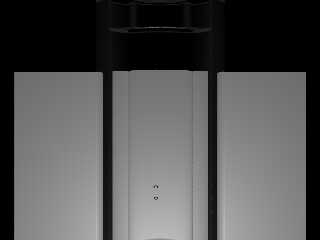

Hello Forum,
I have been beating my head against an issue in the rendering of scene.   I have
bubbles entrained in a gel, encased in a glass tube.  This is then surrounded by
water, and another clear cylinder containing the water.  I have an area light
backlighting this setup and a camera looking directly through the setup into my
backlight.
When I first rendered my setup, everything was looking good, and so I decided to
run it as an animation, rotating the bubbles around Y axis.  However, when I ran
the animation, the boundary between the glass and water appeared to be speckled,
which immediately made me think of an overlapping surface issue.  I addressed it
by adding an "epsilon" to the radius of my water cylinder's inner surface and
ran it again.  While the speckled surface issue was resolved, a large portion of
my cylinder is being rendered as a dark region, and this region will not go away
no matter what I do.
I have tried repositioning my light, resizing my light, playing with the epsilon
between the water and glass definition, increasing the max_trace_level, and with
the material characteristics of the glass.  In all cases, there seems to be a
new dark region that obscures the outer edges of my gel region.  I think this
of the glass closest to the camera, as the dark region obscures bubbles within
the gel region.
included my code below as I can only attach a single file.
Can anyone help me troubleshoot this issue?
Thank you all for your support and insights!
Sincerely,
Bubble_person
Script Below

From: Bald Eagle
Subject: Re: Dark Regions and Reflections Removal
Date: 9 Dec 2021 21:15:00
Message: <web.61b2b7b264eaca9f1f9dae3025979125@news.povray.org>
You can attach more than one file if you use a newsreader like Thunderbird.
You can also post your scene in the scene files area with a link to it here, or
just post twice - once with the render illustrating your problem, and again with
your scene file as an attachment.
I haven't done a _lot_ with your file, but I just played around with
restructuring some things and see what was where.
Take a look through what I did - I have a #switch block to use a top-down view
with simple textures to get a clear look at your objects, and did some other
things with an array and a macro for your bubbles.
Just change the value of "Render" to "Setup" or "Scene" to see how that works.
I changed some textures and made all the merges unions trying to speed it up -
so you may need to change some of those back.
With the small amount of work I did - I'm thinking that you might need to take a
look at your geometry and make sure everything is sized properly and nests the
way you think it does.
With regard to the speckles, I think what you should try is just differencing
your bubbles away from the gel instead of adding them in as objects with a whole
material definition.   You only need an interior with an ior if it's different
than air.  Think of your bubbles not air bubbles of air - but of spherical
regions where the gel has been subtracted away or excluded.

I find it very interesting that you successfully instantiate objects without
using the object {} wrapper!  :O
..oO(This scene is never gonna render without an error the way it's written...)
And it DID!
These things can always be really tricky - sometimes for quite complex reasons,
but other times for the most ridiculously simple reasons that are hard to see.
I'm thinking that you should "build up" your geometry from the center outwards,
using thickness values rather than distinct radii.   It's simpler (in my mind)
to do it that way without error, and if you ever change a value, everything else
still works because it's already "parameterized".
So,
gel_radius
gel radius + epsilon
gel_radius + epsilon + tube_thickness
gel_radius + epsilon + tube_thickness + epsilon
gel_radius + epsilon + tube_thickness + epsilon + water_thickness
etc

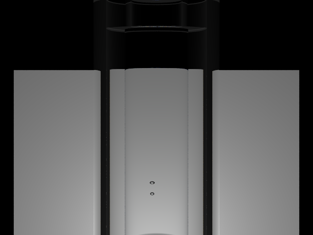

Looks like the placement of the light_source was a major source of your
headaches.
I putzed around with this a bit more, and it's looking much better - hopefully
you can tweak things from here.
Download 'glasstube.png' (55 KB)
