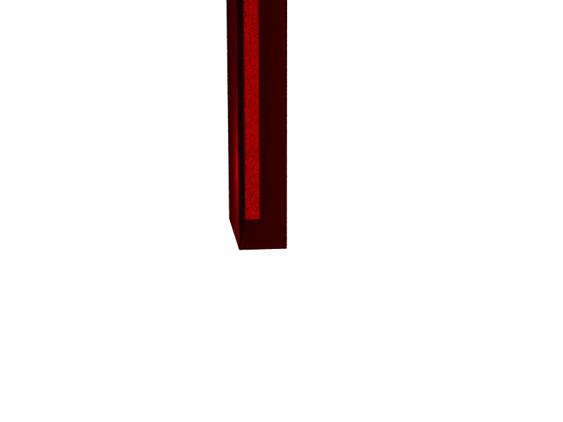

I have attached a rendering of your image with the one of the lights
relocated to your camera position. Notice taht you can now see that some
material has been removed by your difference CSG. You can also see speckled
artifacts on some interior surfaces. These are caused by the coincidence
surfaces.
These are the same types of issues I faced when I first started with POV
Ray. Welcome to the learning curve!
