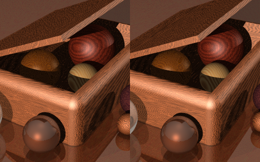

I've been playing around with just this topic. I've been using POV's
standard "woodbox.pov" file to develope the procedure. Here's what I have
so far.
Replace the original camera with the following;

The comments should be easy to follow. As of now I use two files; left and
right. My next step is to combine them into one two-frame animation file so
that both will be generated in one pass. I've also used an 8/5 aspect ratio
for display on my 8/5 monitor. In the resolution.ini file add the
following;
[512/2*320, AA 0.3]
Width=256
Height=320
Antialias=on
AQntialias_Threshold=0.3
Also, I used Paint Shop Pro to combine the two images.
I use the "cross-eyed" viewing method (right eye image on the left - left
eye image on the right) because it isn't limeted in spacing as the "splay-
eyed" viewing method.
Im including the entire "woodbox.pov" file for one side and a copy of my
derived image.

           < 3.75, 1.75,  0.0>, 0.5 }
#declare Front_Left_Edge  =
cylinder { <-3.75, 0.00,  0.0>,
           <-3.75, 1.75,  0.0>, 0.5 }
#declare Front_UL_Corner  = sphere   { <-3.75, 1.75,  0.0>, 0.5 }
#declare Front_UR_Corner  = sphere   { < 3.75, 1.75,  0.0>, 0.5 }
#declare Left_Panel      = box { <-0.50, 0, -2.75>, <0.50, 1.75, 2.75> }
#declare Left_Top_Edge   = cylinder { <0, 1.75, -2.75>, <0, 1.75, 2.75>,
0.5 }
#declare Left_End =
intersection {
    union {
        object { Left_Panel       }
        object { Left_Top_Edge    }
    plane { x, 0 }
    texture { T2 }
    bounded_by { box { <-0.501, 0.01, -3.251>, <0.01, 2.251, 3.251> } }
#declare Box_Front =
intersection {
    union {
        object { Front_Panel      }
        object { Front_Top_Edge   }
        object { Front_Left_Edge  }
        object { Front_Right_Edge }
        object { Front_UL_Corner  }
        object { Front_UR_Corner  }
    plane { z, 0 }
    texture { T1}
    bounded_by { box { <-4.251, 0.01, -0.51>, <4.251, 2.251,  0.01> }}
#declare Box_Bottom = box {<-3.75, 0.0, -2.75> <3.75, 0.25, 2.75> texture
{T3} }
#declare Box_Lid =    box {<-3.75, 0.0, -2.75> <3.75, 0.25, 2.75>
    translate -2.75*z    // put "hinge" at origin
    rotate x*25          // open the lid
    translate 2.75*z     // move "hinge" back
    translate y*2        // lift to top
    texture {T3}
#declare Box =
union {
    object { Box_Front translate -z*2.75}
    object { Box_Front scale <1,1,-1> translate z*2.75}
    object { Left_End translate -x*3.75 }
    object { Left_End scale <-1,1,1> translate x*3.75 }
    object { Box_Lid  }
    object { Box_Bottom }
#declare Spheres =
union {
    // Inside of box
    sphere { <1.5, 1.5, -0.75>, 1.25
        texture {
            T_Wood14
            finish { specular 0.35 roughness 0.05 ambient 0.3 }
            translate x*1
            rotate <15, 10, 0>
            translate y*2
    // Inside of box
    sphere { <-1.5, 1.25,  0.5>, 1
        texture { T_Wood18
            finish { specular 0.25 roughness 0.025 ambient 0.35 }
            scale 0.33
            translate x*1
            rotate <10, 20, 30>
            translate y*10
    // Inside of box
    sphere { <-0.75, 1.0, -1.5>, 0.75
        texture { T_Wood10
            finish { specular 0.5 roughness 0.005 ambient 0.35 }
            translate x*1
            rotate <30, 10, 20>
    // Outside of box
    sphere { <-0.75, 0.75, -4.25>, 0.75
        texture { T_Wood4
            finish { specular 0.25 roughness 0.015 ambient 0.2 }
    // Outside of box
    sphere { <-2.25, 0.45, -4.5>, 0.45
        texture { T_Wood20
            finish { specular 0.15 roughness 0.15 ambient 0.3 }
            rotate <45, 10, 45>
            translate x*10
    // Outside of box
    sphere { <-5.5, 0.95, 0.8>, 0.95 texture { T_Glass4 } interior {I_Glass
caustics 1} }
    // Outside of box
    sphere { <-5.00, 0.75, -2.0>, 0.75 texture { T_Copper_2B} }
    // Outside of box
    sphere { <-1.75, 0.40, -5.4>, 0.40 texture { T_Brass_3B} }
union {
    object { Floor }
    object { Box }
    object { Spheres }
    rotate -y*35
Download 'woodbox-3D.bmp' (481 KB)

Ajees, Alain,
you should transpose the "look_at" by the same vector.
You can use the software Stereopteryx (http://www.midicond.de/Freeware/) to view
stereo images, even very large ones, in "parallel view". The help function
includes some more hints about POV. Have fun!
Alex
