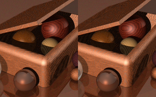

From: John Salmon
Subject: Re: stereo camera - 1 attachment (1/2)
Date: 28 May 2005 16:05:59
Message: <Xns966499923FC48jsalmonhoustonrrcom@203.29.75.35>
"Ajees" <ala### [at] yahoocom> wrote in
news:web.429755fca665835a5ea7462e0@news.povray.org:
> Hai
> I wish to create a stereo pictuers side by side (left and right) for
> my molecule using the following camera position.
> // Pov 'camera'
> //  to view default ribbons box:  X+-25; Y+-20
> /**** pov-image script should replace this with something:
> camera {
>  //location <0.0,0.0,500.0>    // far away in Z
>  // for stereo, eye-separation = 0.1*distance
>  location <25.0,0.0,500.0> // stereo 'Right' Z
>  //location <-25.0,0.0,500.0>// stereo 'Left' Z
>  up y                        // like the screen
>  right -5/4*x                // makes right-handed
>  angle 5.73                  // 2*atan(25/500)
>  look_at <0.0,0.0,0.0>       // origin of ribbons box
> I will just comment / uncomment the Left and Right location to get the
> two pictures. Unfortunatley the pictures which I am getting is not 3
> dimensional.
> Is there any suggestions?
> Thanking you,
> Yours
> Ajees
I've been playing around with just this topic. I've been using POV's
standard "woodbox.pov" file to develope the procedure. Here's what I have
so far.
Replace the original camera with the following;
// Replace the original camera with this
// Save the original camera location
#declare viewLoc = <-7, 10, -15>;
// Save the original look_at location
#declare lookAt = <0, 0, 0>;
// Find the actual vector between the camera and the location looked at
#declare lookDir = lookAt - viewLoc;
// Make sure that up is the same for the camera and for the calculations
#declare vrt = y;
// Use cross product to fins a vector perpindicular to both up and the
// viewing direction and normalize it.
#declare eyeDir = vnormalize(vcross(lookDir, vrt));
// Find the distance between the camera and the location looked at
#declare lookDist = vlength(lookDir);
// Scale the eye seperation for good viewing. The value 20 seems to work
// well, but can be changed
#declare eyeSep = lookDist / 20;
// Find the positions of the eyes
#declare leftEye = viewLoc + (eyeSep / 2.0) * eyeDir;           // One of
these will
#declare rightEye = viewLoc - (eyeSep / 2.0) * eyeDir;          //   be
unused
// Now, use the above info
camera {
// location leftEye             // Use this one in the left eye file
   location rightEye
   direction <0, 0,  2.25>
   up vrt
   right x * 0.8
   look_at lookAt
The comments should be easy to follow. As of now I use two files; left and
right. My next step is to combine them into one two-frame animation file so
that both will be generated in one pass. I've also used an 8/5 aspect ratio
for display on my 8/5 monitor. In the resolution.ini file add the
following;
[512/2*320, AA 0.3]
Width=256
Height=320
Antialias=on
AQntialias_Threshold=0.3
Also, I used Paint Shop Pro to combine the two images.
I use the "cross-eyed" viewing method (right eye image on the left - left
eye image on the right) because it isn't limeted in spacing as the "splay-
eyed" viewing method.
Im including the entire "woodbox.pov" file for one side and a copy of my
derived image.

           < 3.75, 1.75,  0.0>, 0.5 }
#declare Front_Left_Edge  =
cylinder { <-3.75, 0.00,  0.0>,
           <-3.75, 1.75,  0.0>, 0.5 }
#declare Front_UL_Corner  = sphere   { <-3.75, 1.75,  0.0>, 0.5 }
#declare Front_UR_Corner  = sphere   { < 3.75, 1.75,  0.0>, 0.5 }
#declare Left_Panel      = box { <-0.50, 0, -2.75>, <0.50, 1.75, 2.75> }
#declare Left_Top_Edge   = cylinder { <0, 1.75, -2.75>, <0, 1.75, 2.75>,
0.5 }
#declare Left_End =
intersection {
    union {
        object { Left_Panel       }
        object { Left_Top_Edge    }
    plane { x, 0 }
    texture { T2 }
    bounded_by { box { <-0.501, 0.01, -3.251>, <0.01, 2.251, 3.251> } }
#declare Box_Front =
intersection {
    union {
        object { Front_Panel      }
        object { Front_Top_Edge   }
        object { Front_Left_Edge  }
        object { Front_Right_Edge }
        object { Front_UL_Corner  }
        object { Front_UR_Corner  }
    plane { z, 0 }
    texture { T1}
    bounded_by { box { <-4.251, 0.01, -0.51>, <4.251, 2.251,  0.01> }}
#declare Box_Bottom = box {<-3.75, 0.0, -2.75> <3.75, 0.25, 2.75> texture
{T3} }
#declare Box_Lid =    box {<-3.75, 0.0, -2.75> <3.75, 0.25, 2.75>
    translate -2.75*z    // put "hinge" at origin
    rotate x*25          // open the lid
    translate 2.75*z     // move "hinge" back
    translate y*2        // lift to top
    texture {T3}
#declare Box =
union {
    object { Box_Front translate -z*2.75}
    object { Box_Front scale <1,1,-1> translate z*2.75}
    object { Left_End translate -x*3.75 }
    object { Left_End scale <-1,1,1> translate x*3.75 }
    object { Box_Lid  }
    object { Box_Bottom }
#declare Spheres =
union {
    // Inside of box
    sphere { <1.5, 1.5, -0.75>, 1.25
        texture {
            T_Wood14
            finish { specular 0.35 roughness 0.05 ambient 0.3 }
            translate x*1
            rotate <15, 10, 0>
            translate y*2
    // Inside of box
    sphere { <-1.5, 1.25,  0.5>, 1
        texture { T_Wood18
            finish { specular 0.25 roughness 0.025 ambient 0.35 }
            scale 0.33
            translate x*1
            rotate <10, 20, 30>
            translate y*10
    // Inside of box
    sphere { <-0.75, 1.0, -1.5>, 0.75
        texture { T_Wood10
            finish { specular 0.5 roughness 0.005 ambient 0.35 }
            translate x*1
            rotate <30, 10, 20>
    // Outside of box
    sphere { <-0.75, 0.75, -4.25>, 0.75
        texture { T_Wood4
            finish { specular 0.25 roughness 0.015 ambient 0.2 }
    // Outside of box
    sphere { <-2.25, 0.45, -4.5>, 0.45
        texture { T_Wood20
            finish { specular 0.15 roughness 0.15 ambient 0.3 }
            rotate <45, 10, 45>
            translate x*10
    // Outside of box
    sphere { <-5.5, 0.95, 0.8>, 0.95 texture { T_Glass4 } interior {I_Glass
caustics 1} }
    // Outside of box
    sphere { <-5.00, 0.75, -2.0>, 0.75 texture { T_Copper_2B} }
    // Outside of box
    sphere { <-1.75, 0.40, -5.4>, 0.40 texture { T_Brass_3B} }
union {
    object { Floor }
    object { Box }
    object { Spheres }
    rotate -y*35
Download 'woodbox-3D.bmp' (481 KB)
From: John Salmon
Subject: Re: stereo camera - 1 attachment (2/2)
Date: 28 May 2005 16:06:05
Message: <Xns9664999B81DE8jsalmonhoustonrrcom@203.29.75.35>
From: Warp
Date: 28 May 2005 16:11:39
Message: <4298d07b@news.povray.org>
Do not post binary attachments to non-binearies groups (post them
to povray.binaries.* groups instead). Specially not huge bmp files.
  Please cancel your posts here and repost them at povray.binaries.images
or another relevant binaries group.
                                                          - Warp
From: John Salmon
Date: 28 May 2005 16:22:42
Message: <Xns96649C6FBBA9Cjsalmonhoustonrrcom@203.29.75.35>
From: AS
Date: 8 Jul 2010 11:05:00
Message: <web.4c35e8f2db01aca5e9a5cddd0@news.povray.org>
Ajees, Alain,
you should transpose the "look_at" by the same vector.
You can use the software Stereopteryx (http://www.midicond.de/Freeware/) to view
stereo images, even very large ones, in "parallel view". The help function
includes some more hints about POV. Have fun!
Alex
