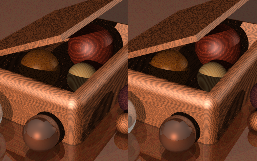

From: John Salmon
Subject: Re: stereo camera - 1 attachment (1/2)
Date: 28 May 2005 16:05:59
Message: <Xns966499923FC48jsalmonhoustonrrcom@203.29.75.35>
"Ajees" <ala### [at] yahoocom> wrote in
news:web.429755fca665835a5ea7462e0@news.povray.org:
> Hai
> I wish to create a stereo pictuers side by side (left and right) for
> my molecule using the following camera position.
> // Pov 'camera'
> //  to view default ribbons box:  X+-25; Y+-20
> /**** pov-image script should replace this with something:
> camera {
>  //location <0.0,0.0,500.0>    // far away in Z
>  // for stereo, eye-separation = 0.1*distance
>  location <25.0,0.0,500.0> // stereo 'Right' Z
>  //location <-25.0,0.0,500.0>// stereo 'Left' Z
>  up y                        // like the screen
>  right -5/4*x                // makes right-handed
>  angle 5.73                  // 2*atan(25/500)
>  look_at <0.0,0.0,0.0>       // origin of ribbons box
> I will just comment / uncomment the Left and Right location to get the
> two pictures. Unfortunatley the pictures which I am getting is not 3
> dimensional.
> Is there any suggestions?
> Thanking you,
> Yours
> Ajees
I've been playing around with just this topic. I've been using POV's
standard "woodbox.pov" file to develope the procedure. Here's what I have
so far.
Replace the original camera with the following;
// Replace the original camera with this
// Save the original camera location
#declare viewLoc = <-7, 10, -15>;
// Save the original look_at location
#declare lookAt = <0, 0, 0>;
// Find the actual vector between the camera and the location looked at
#declare lookDir = lookAt - viewLoc;
// Make sure that up is the same for the camera and for the calculations
#declare vrt = y;
// Use cross product to fins a vector perpindicular to both up and the
// viewing direction and normalize it.
#declare eyeDir = vnormalize(vcross(lookDir, vrt));
// Find the distance between the camera and the location looked at
#declare lookDist = vlength(lookDir);
// Scale the eye seperation for good viewing. The value 20 seems to work
// well, but can be changed
#declare eyeSep = lookDist / 20;
// Find the positions of the eyes
#declare leftEye = viewLoc + (eyeSep / 2.0) * eyeDir;           // One of
these will
#declare rightEye = viewLoc - (eyeSep / 2.0) * eyeDir;          //   be
unused
// Now, use the above info
camera {
// location leftEye             // Use this one in the left eye file
   location rightEye
   direction <0, 0,  2.25>
   up vrt
   right x * 0.8
   look_at lookAt
The comments should be easy to follow. As of now I use two files; left and
right. My next step is to combine them into one two-frame animation file so
that both will be generated in one pass. I've also used an 8/5 aspect ratio
for display on my 8/5 monitor. In the resolution.ini file add the
following;
[512/2*320, AA 0.3]
Width=256
Height=320
Antialias=on
AQntialias_Threshold=0.3
Also, I used Paint Shop Pro to combine the two images.
I use the "cross-eyed" viewing method (right eye image on the left - left
eye image on the right) because it isn't limeted in spacing as the "splay-
eyed" viewing method.
Im including the entire "woodbox.pov" file for one side and a copy of my
derived image.

Download 'woodbox-3D.bmp' (481 KB)

Ajees, Alain,
you should transpose the "look_at" by the same vector.
You can use the software Stereopteryx (http://www.midicond.de/Freeware/) to view
stereo images, even very large ones, in "parallel view". The help function
includes some more hints about POV. Have fun!
