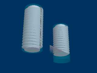

Hi,
In the attached image (this is a view from below).
In the center, the object built from the union of a cylinder and a mesh.
On the right, the same object “cut” at the base by a plane
difference {
  object { Screw }
  plane { y,0 }
And then, as you can see, something “weird” happens.
If I make the difference with a box, it's the same thing.
And, if instead of “cutting” at the bottom, I cut at the top, the same
thing happens. It can't be a problem of surface coincidence. The values
are quite different, in fact.
Do you have any ideas for solving this issue ?
nb: the vertical black line with the balls is simply  gauge to check the
screw pitch and has nothing to do with the problem.
kurtz le pirate
compagnie de la banquise
Download 'issue.jpg' (61 KB)
Preview of image 'issue.jpg'

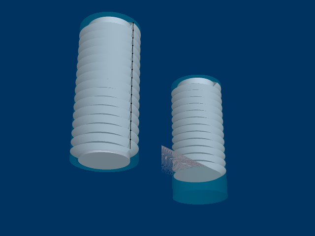

Yes, with simple objects, no issue.
I made others tests. The base object ranges from -1 to 31.
If I try with another y value (say 5) i get the same issue at y = 5.0
has you can see.
I also added the cylinder object limits.
I'm still trying to figure out what's so special about this mesh ...
kurtz le pirate

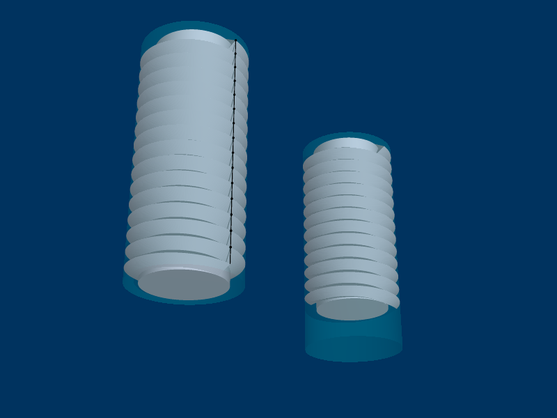

Here, the same things rendered with yuqk* :(
* : look in p.b.programming. I have strange errors with yuqk
kurtz le pirate
Download 'screew_yuqk.png' (63 KB)
Preview of image 'screew_yuqk.png'

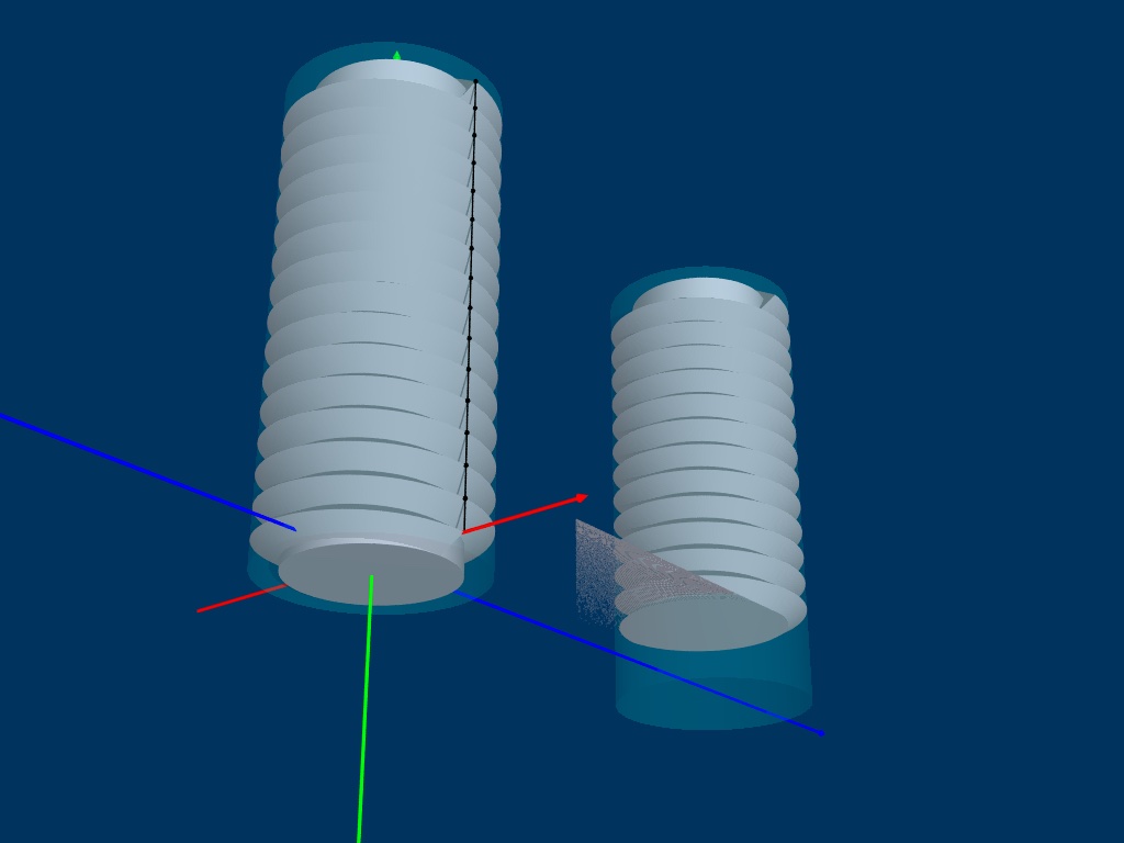

I rebuilt yuqk with the right option (THANKS Jr).
I went back to my 3.8 source code, added the right lines for version
3.8.0-x.yuqk_a5c25dda and re-rendered. As expected, the names of my
variables are accepted without any problem.
I'm happy.
Attached is a summary of this "magnificent" scene.
Do you see the problem ?
The issue I mentioned earlier has disappeared !
What is the relationship between the "--disable-no-lc-identifiers" and
the difference  { } opération ?
A new leap into the 5th dimension :(
kurtz le pirate
Download 'vis_yuqk_ok.png' (85 KB)
Preview of image 'vis_yuqk_ok.png'
