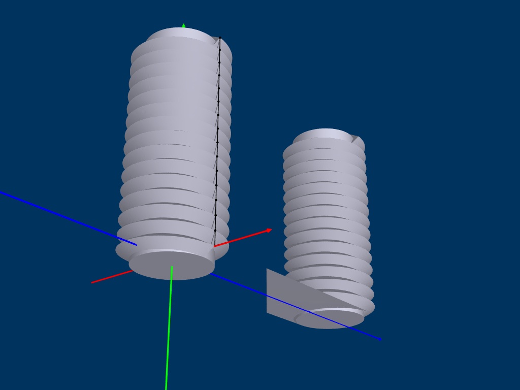

Hi,
In the attached image (this is a view from below).
In the center, the object built from the union of a cylinder and a mesh.
On the right, the same object “cut” at the base by a plane
difference {
  object { Screw }
  plane { y,0 }
And then, as you can see, something “weird” happens.
If I make the difference with a box, it's the same thing.
And, if instead of “cutting” at the bottom, I cut at the top, the same
thing happens. It can't be a problem of surface coincidence. The values
are quite different, in fact.
Do you have any ideas for solving this issue ?
nb: the vertical black line with the balls is simply  gauge to check the
screw pitch and has nothing to do with the problem.
kurtz le pirate

Bonjour/Hello
When you try to make a difference or merge CSG operation with isosurface
objects, you should use the "max trace 'intersections number'" (to write
in the isosurface statement at the end ideally) keyword so POVRay
doesn't stop at the first collision between rays and the isosurface
object. So far, I don't know if you used the max_trace keyword because
we don't have all the code.
What version of POV-Ray are you using? There were v3.8 development
versions over time with difference issues.
If not a problematic version of POV-Ray, I'd bet next on something with
the mesh, but...?

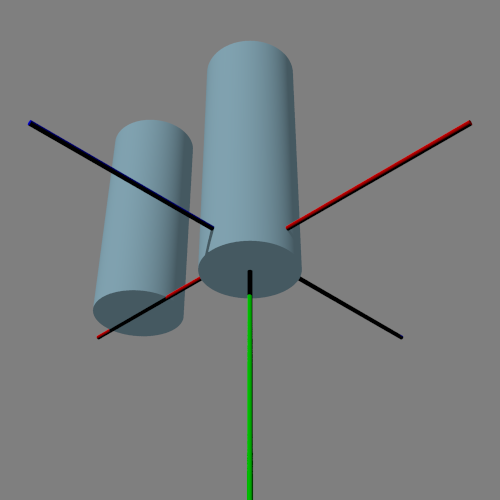

I tried a simple cylinder scene and things look OK test one each of the
v3.7 and v3.8 compiles I have in hand.
#declare Cyl00 = cylinder {
     <0,-0.1,0>, <0,1,0>, 0.2
     pigment { rgb <0.3,0.5,0.6> }
     finish { emission 0.2 }
difference {
   object { Cyl00 translate <-0.7,0,0> }
   plane { y,0 }
   cutaway_textures
object { Cyl00 }
Bill P.
Download 'tmp38.png' (28 KB)

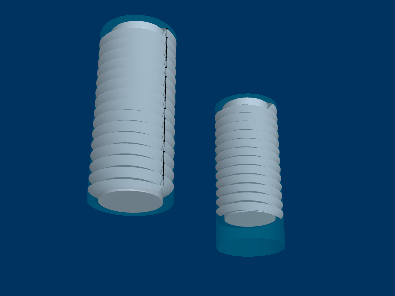

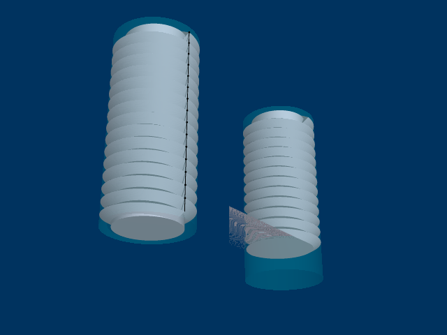

Yes, with simple objects, no issue.
I made others tests. The base object ranges from -1 to 31.
If I try with another y value (say 5) i get the same issue at y = 5.0
has you can see.
I also added the cylinder object limits.
I'm still trying to figure out what's so special about this mesh ...
kurtz le pirate
compagnie de la banquise

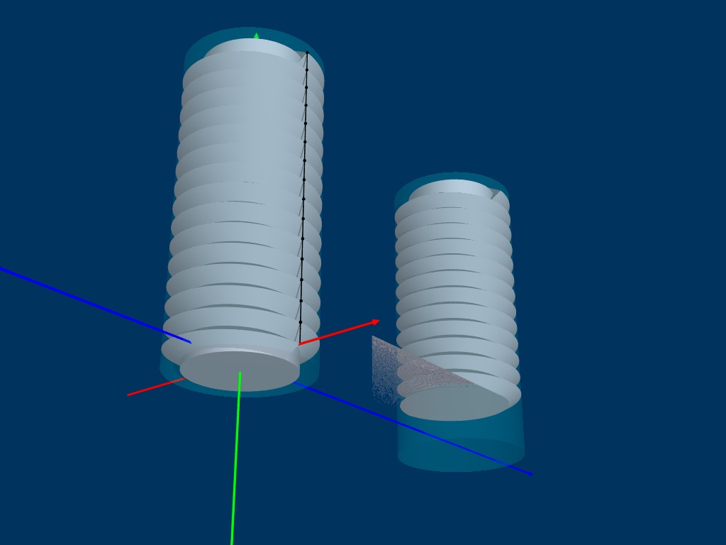

Here, the same things rendered with yuqk* :(
* : look in p.b.programming. I have strange errors with yuqk
kurtz le pirate
